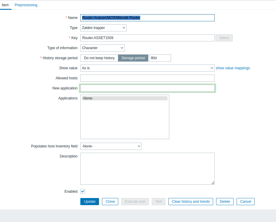

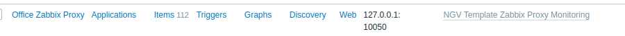

    There is a host called Office Zabbix Proxy, and it does have a trapper item with key Router.ASSET1509. See attached screen-shots.

    Are you certain that "Office Zabbix Proxy" is the technical name for the host within Zabbix? It cannot be the display name, it must be the host name.

        Thank you! I was using the display name. Now I'm using the technical (host) name and it is working.
