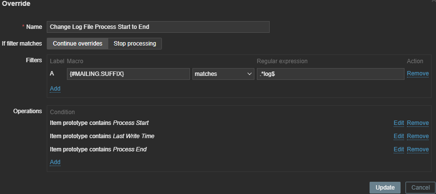

        I tried messing up with JSON but I ended up having to double the item prototypes and macros. What a mess.
        Then, I tried adding just one more item with key changes and added a few override steps.
        That worked like magic! Great Semiadmin
