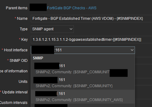

    In Zabbix 5.4 I was able to create Discovery Rules and Item Prototypes and change the SNMP Interface on the Discovery Rule and on the Item Prototype.

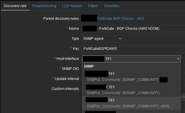

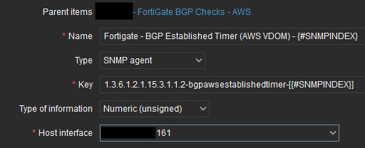

    In Zabbix 6.0.6 I am able to change the Host Interface on the Discovery Rule, but the drop down on the Item Prototype does not work.
    Please see attached for examples of the issue.
    Zabbix 5.4, I'm able to change the Host Interface on both the Discovery Rule and the Item Prototype
    Zabbix 6.0, I'm able to change the Host Interface on the Discovery Rule, however, the Host Interface on the Item Prototype does not allow me to drop down and select the appropriate SNMP Host Interface
