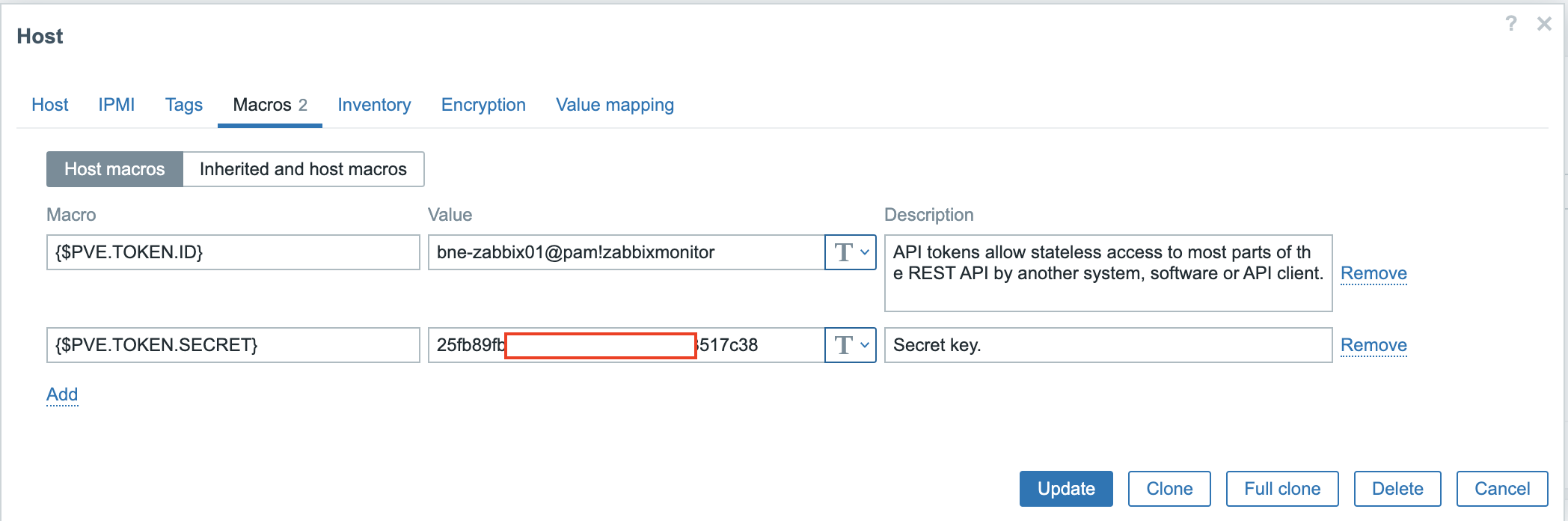

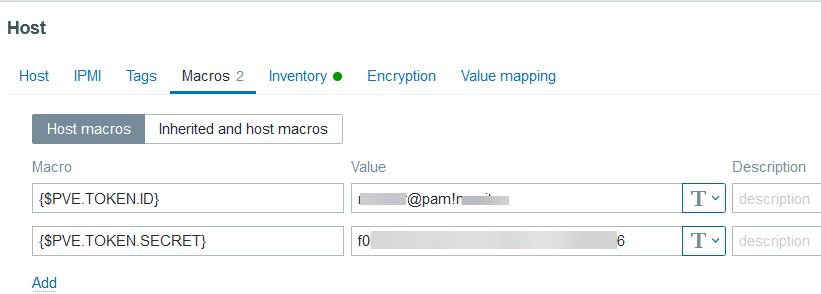

    -- Macros were set up.

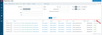

    Click image for larger version  Name:	macros-proxmox.png Views:	0 Size:	17.1 KB ID:	448126

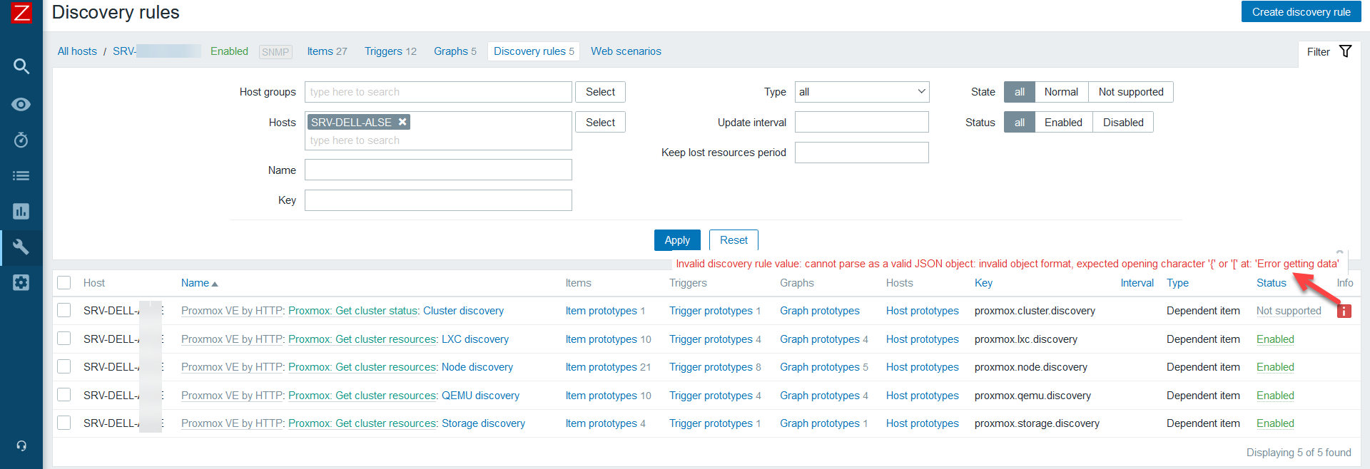

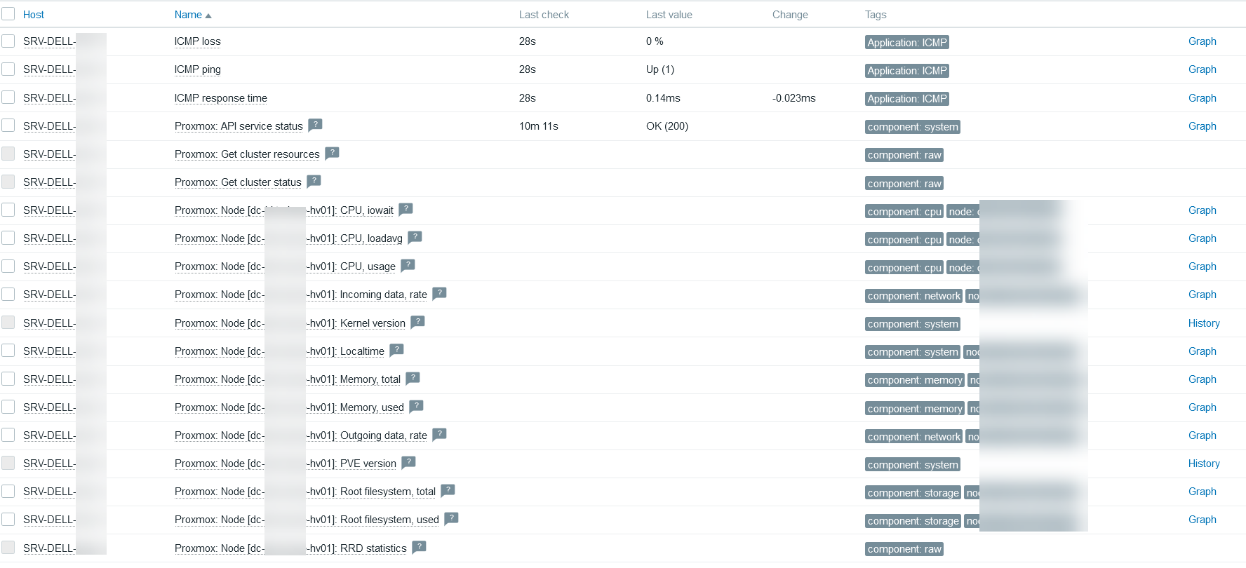

    Some itens were discovered, API Status returned OK (200) but all the other LLD itens need the Master Item: Proxmox: Get cluster resources / and Status.
    Click image for larger version  Name:	proxmox-itens.png Views:	0 Size:	138.1 KB ID:	448131
    This itens don't return anything.

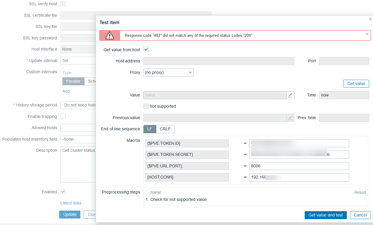

    ​ Click image for larger version  Name:	proxmox-test-item-cluster-status.png Views:	0 Size:	93.6 KB ID:	448132
    On the next prints, I tested the Itens:
    TESTING Proxmox: Get cluster status
    Click image for larger version  Name:	proxmox-test-item-cluster-status2.png Views:	0 Size:	63.5 KB ID:	448130

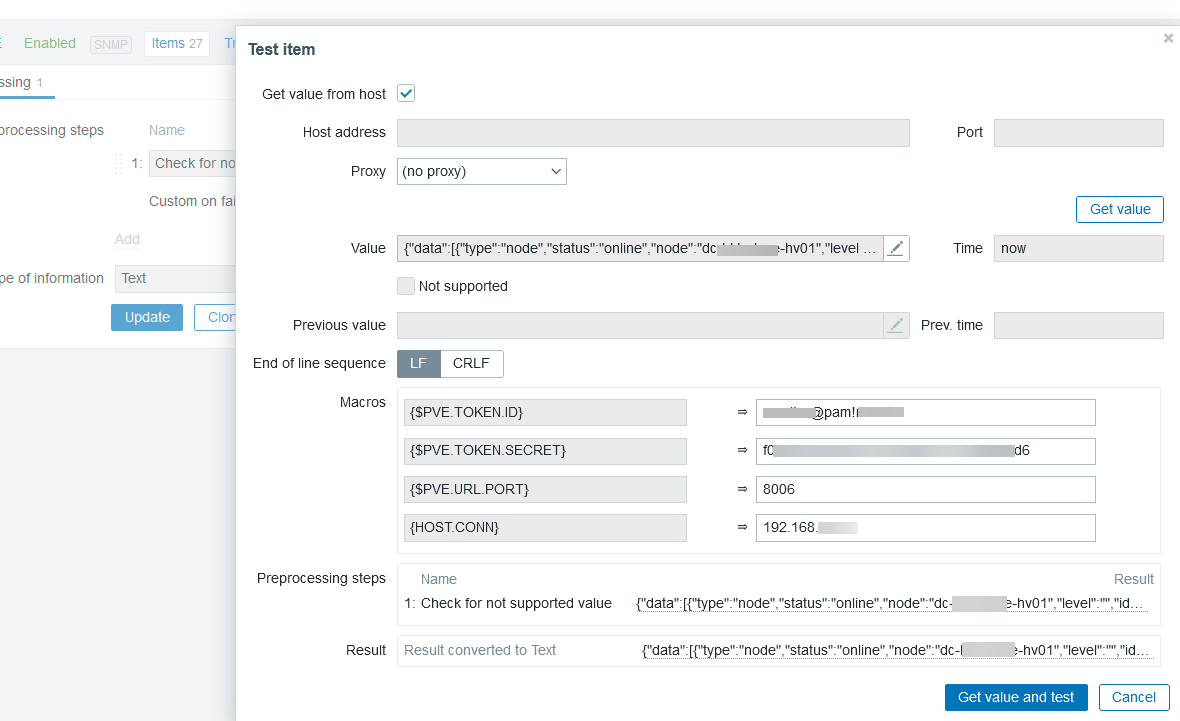

    TESTING Proxmox: Get cluster resources
    Click image for larger version  Name:	proxmox-test-item-resource.png Views:	0 Size:	50.3 KB ID:	448128

          I have created the api token, and assigned all needed privs.
          For troubleshooting i have even given the token admin privs.

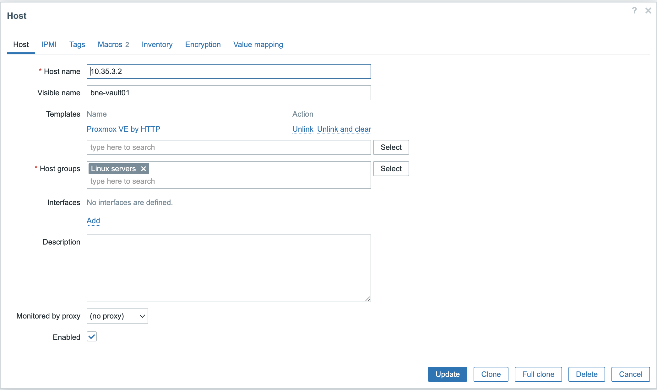

          I have even tried reconfiguring the host within zabbix with ip instead of fqdn
          Screenshots of config attached
          Can any of you point me in the right direction ?
          All the best
          Ras
          • Homex
            • Nov 2017
            Hi Raslin
            The template use the variable {HOST.CONN}
            So please check that you put IP or DNS name in Interfaces/Agent section
