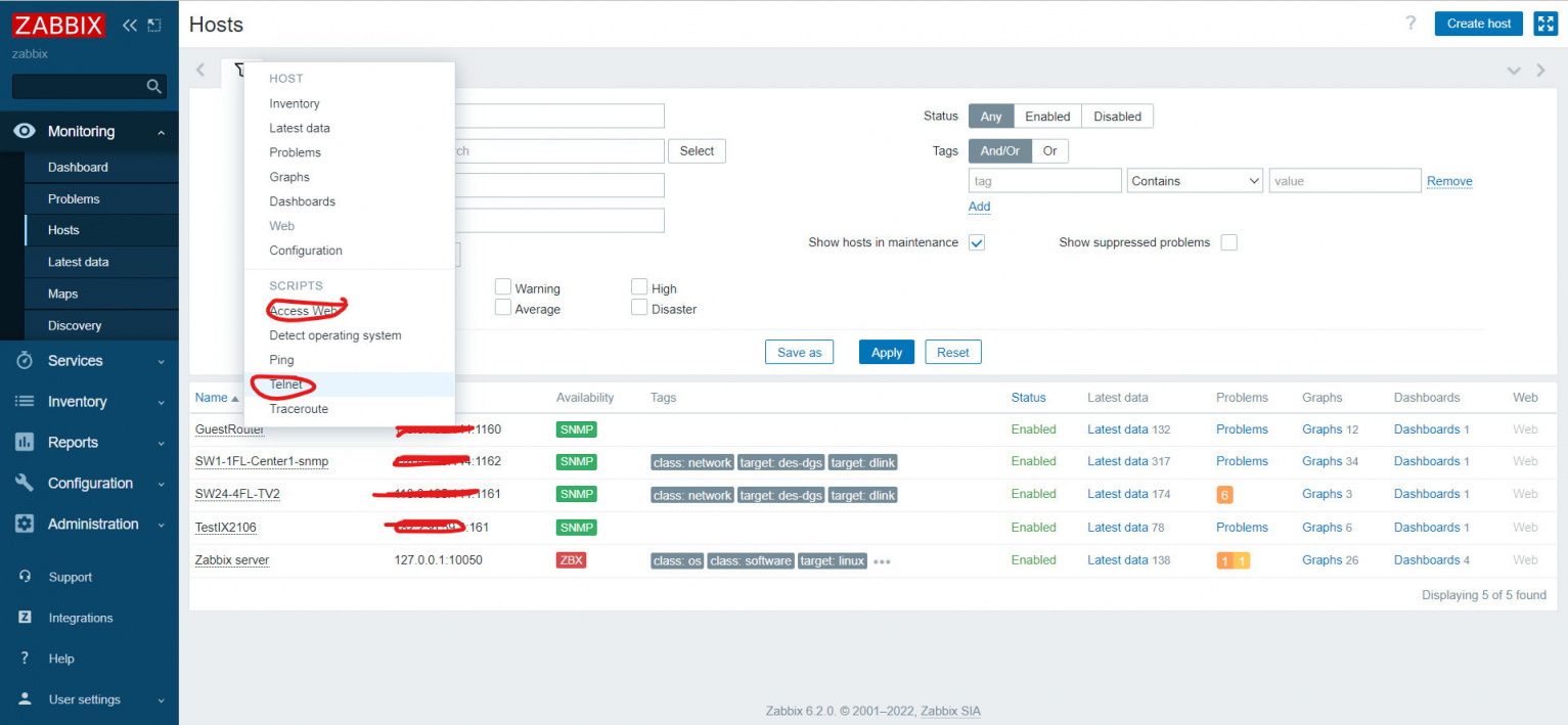

    I have several remote admin network devices (switches, routers,...)
    I have NAT out public ip services (web, telnet, ssh, snmp,..)
    For example
    I have 1 router, 5 switches.
    public IP: 172.1.3.5
    NAT port 80 out 8081 -> 8086
    Likewise I nat telnet, ssh, snmp services.
    Now I can monitor 6 devices above (1 router and 5 switches) via nat snmp port on zabbix.
    I want to create a script with the name "Access Web".
    Clicking on [router] opens a new browser tab with the URL 172.1.3.5:8081
    When clicking on [switch1] the same is 172.1.3.5:8082
    The same script with the name "Telnet" will be able to telnet.
    Thank you for helping me

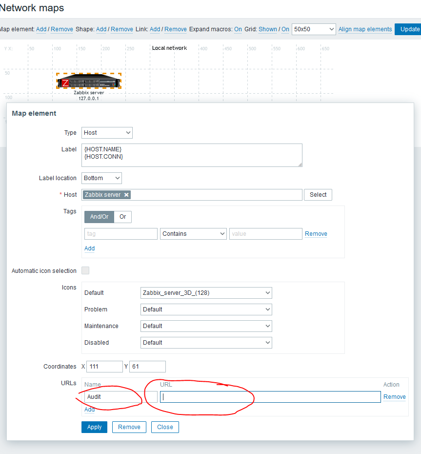

    You can start external scripts on the Zabbix server side only. But you can assign your URL for the map element at any created map

          I will try. Thanks for your reply.
