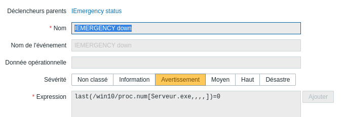

    I have a question, so i work with Zabbix 6.0.2 and i have an host on Windows 10,
    i need to monitor if a process is running or not on my machine, the process is this one, (its not a service, its a applications)
    Click image for larger version  Name:	3.png Views:	0 Size:	3.1 KB ID:	448165
    i've tried this for my items and trigger on my zabbix server
    Click image for larger version  Name:	4.png Views:	0 Size:	20.2 KB ID:	448166 Click image for larger version  Name:	5.png Views:	0 Size:	23.6 KB ID:	448168
    i understand this trigger like "if server.exe = 0 (not running) then there is a problem"
    but i dont have any data on my dashboard or on latest data and i have the error "to many parameter " but i only have one :/
    Thanks in advance

    https://www.zabbix.com/documentation...s/zabbix_agent says that the last parameter to proc.num is only supported on Solaris, so try leaving out one of the commas (or all of them, they are not needed at all).

      Yup just found out .
      Thanks for your help (once again)
