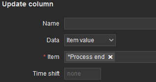

    There are some files monitored by some hosts that all have a similar item name.
    They are "file_name - Process end"
    I wanted to display these files using Top Hosts widget.
    For that, I selected the host group and when I tried to add a column for the file size items, it would not find any of them.
    I tried to use a wildcard (*) at the "item" field like this "*Process end", but it seems that widget does not accept wildcards like Graph does.
    Since item names are similar but not the same between hosts, I cannot create a Top Host widget.
    Do you guys have any idea on how to accomplish such widget?

    This field does not support wildcard characters, only a item.
    While not removed, you can use data overview widget
