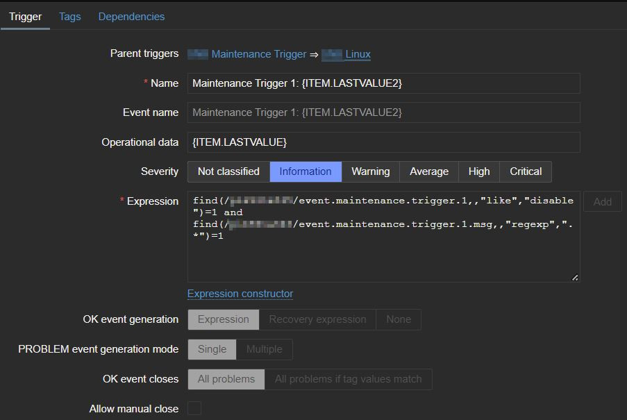

      The expressions I have set up for the Maintenance event is as follows
      find(/server125/event.maintenance.trigger.1,,"like","disable")=1
      and find(/server125/event.maintenance.trigger.1.msg,,"regexp",".*")=1
      I believe that should set the trigger id's to disabled when called with "-o disabled:id1,id2"
      I think I misunderstood what you were asking me, and I hope this is more explanatory.

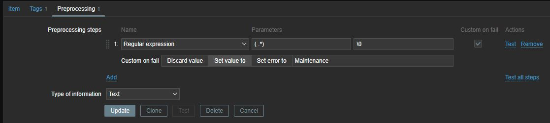

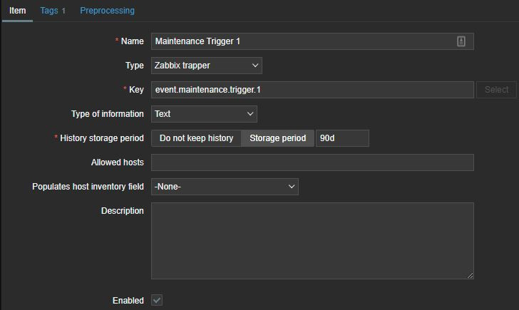

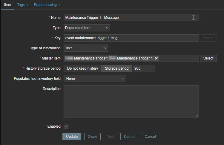

        I have taken a few screenshots of the setup, so you might be able to gather a more full picture.

          Ok so the first item is a trapper item that just gets the value that is sent with zabbix_sender. The second item is a dependent item, just copying the contents of the first item (if I got it correctly).
          So, how are your actions configured? There must be something that does something when the trigger fires.
