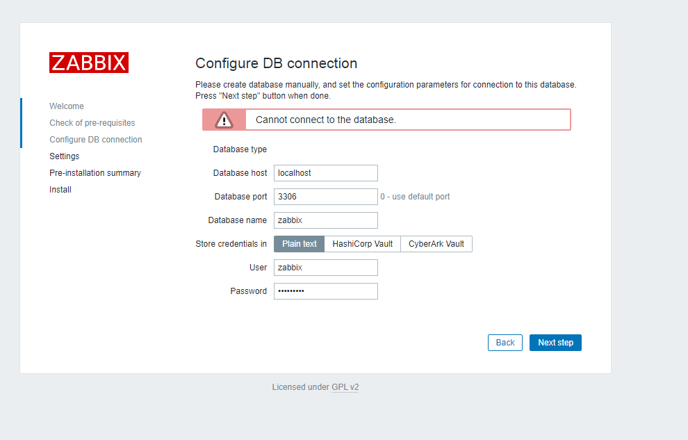

When I install Zabbix, I can't select the initialization interface
  • kcw294196204
    • Aug 2020
    • 15
    My operating system is CentoS7.3 and I compiled and installed Zabbix6.2

    Can someone help me? What's the reason for this?

      Have you installed MySQL server? And is the service started? Also, have you created the database and connection account and populated the initial data?

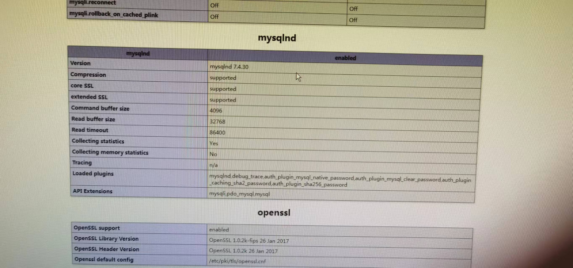

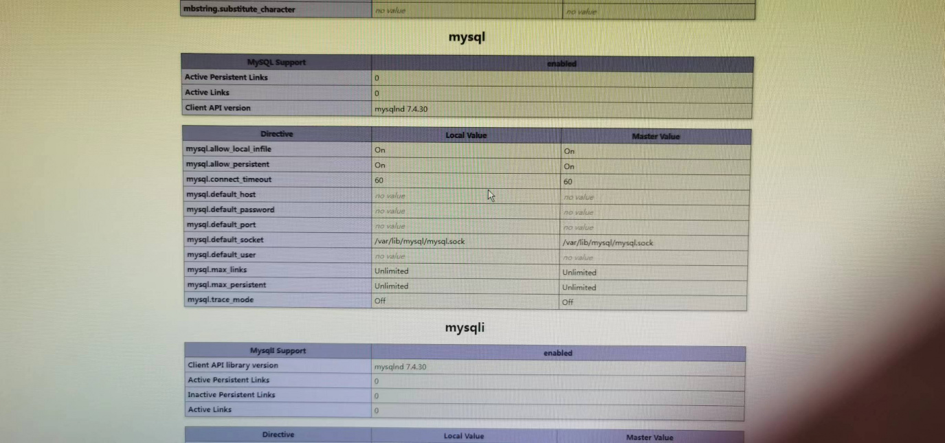

              Originally posted by kcw294196204
              php version is PHP7.4.30
              Do you have any problems looking at this information in PHP output?

                    You don't say anything about what database flavor and version (MySQL 8.0? MariaDB 10.X.Y?) and how you installed them (SCL packages for MariaDB?). Have you verified that the place that your database server is creating its socket is the same place that the PHP mysql config is looking for it? Does mysqli.default_socket_path match where mysqld actually created it?

                      hi,Say hello to you! I have checked php.ini and specified mysqL. sock and restarted PHP74, but the problem still exists
