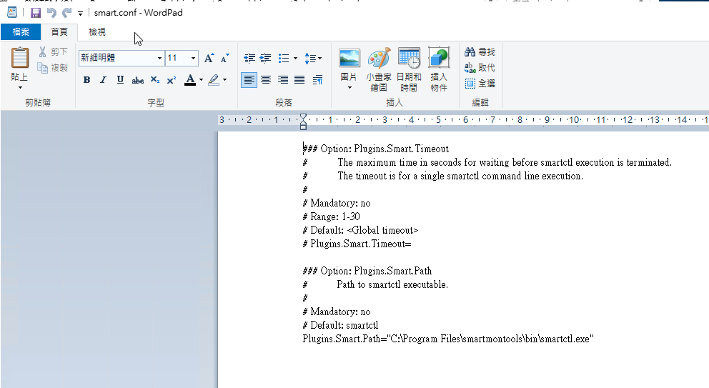

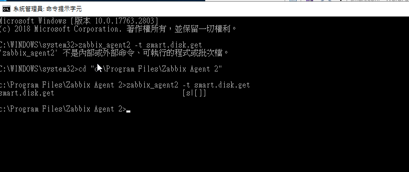

      Yes,I has installed smartmontools and add the line to C:\Program Files\Zabbix Agent 2\zabbix_agent2.d\plugins.d\smart.conf
      I don't know what is this problem.I has restart zabbix agent2.I have another windows machine.It's the same settings.It's all ok.

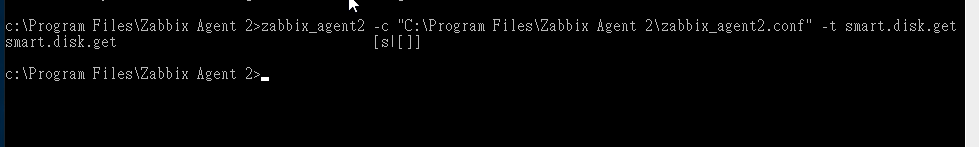

          I test it.
          It's the same error.
