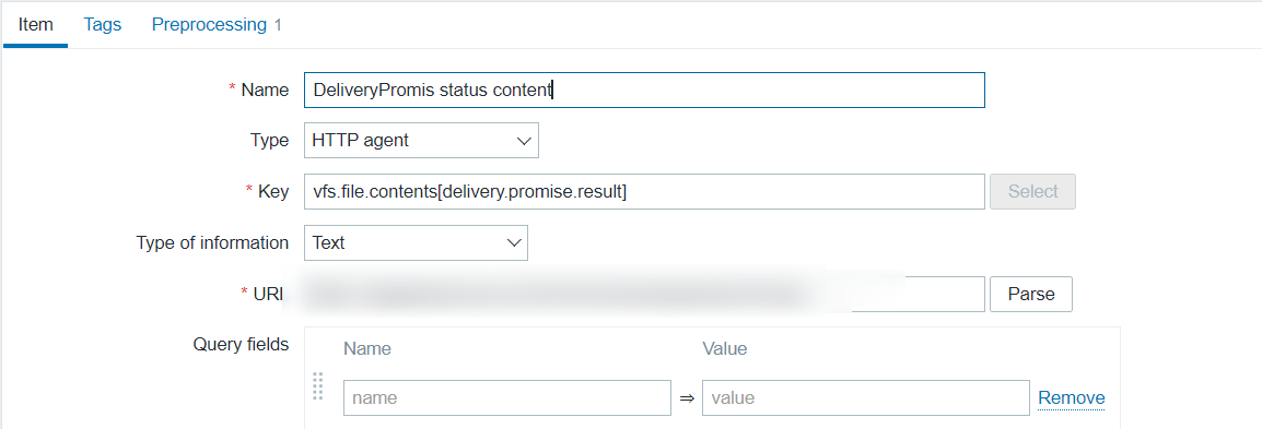

      Hi Cyber,
      thank you for your reply .
      I've created this Item where I receive the needed content from the json file:

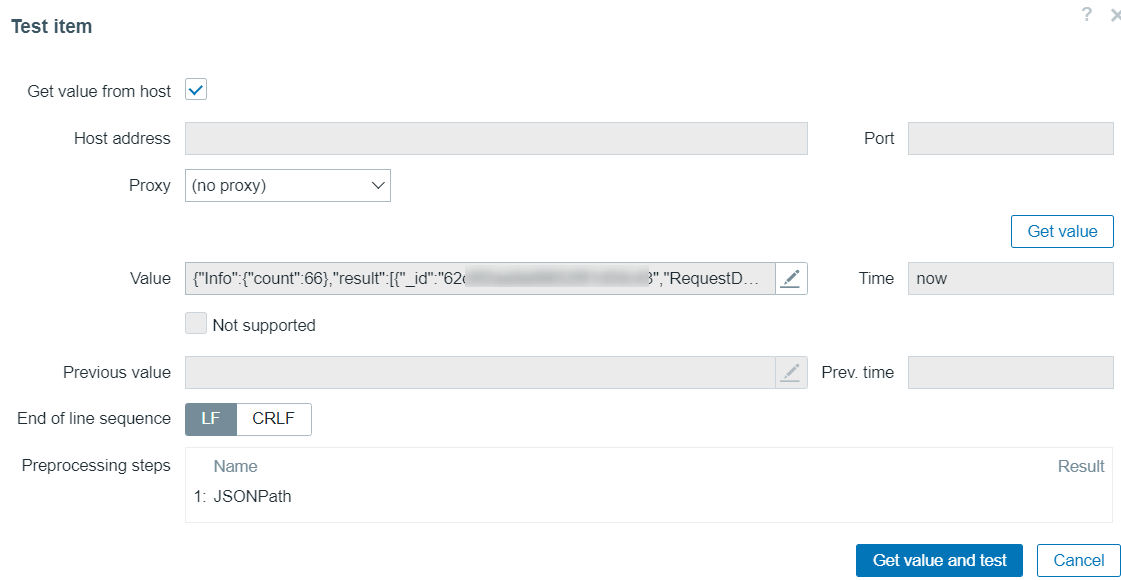

      The test shows me the Infos which I need, I dont have a trigger yet, since I dont know how I should configure it.
      Test:
      I would now need a trigger who shows the infos from the "Value", if this is possible.
      Thanks in advance .

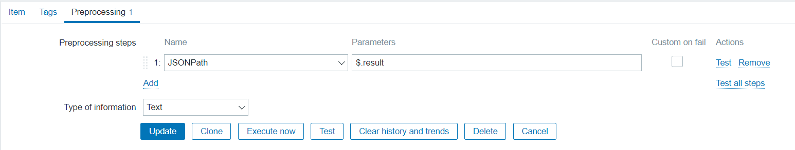

      • vladimir_lv
        • May 2022
        • 240
        Use JSONPath preprocessing to select the number from the JSON
