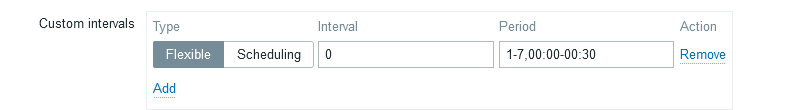

    I'm running into a problem with the item's custom Interval settings.
    In certain hosts, the exclusion period that I put in the Flexible Interval is not being applied correctly.
    As I say, on certain hosts I am running 2 hours after the time set in the period.This has made me think that the problem would be in the timezone, although I imagine that if this were wrong, other things would not work as they should.I have read that the application takes the timezone from the variable PHP_TZ.
    In this variable I have: php_value[date.timezone] = Europe/Madrid
    The strangest thing of all is that it does not happen to me in all the items, in many others it is working correctly.So it makes me think that it has to do with the proxies but I have verified that they all have the timezone correctly.
    I don't know if this is a bug (
    I have version 5) or if there is some configuration that I don't have right.
    Any ideas?
    Thanks!!

    Are using an active check?
    Not available for Zabbix agent active items.
    • jorgeSOT
      • Aug 2022
      No, I don't use an active check.
      I have already solved. In the end the problem was in the docker proxy timezone
      Thanks!!
