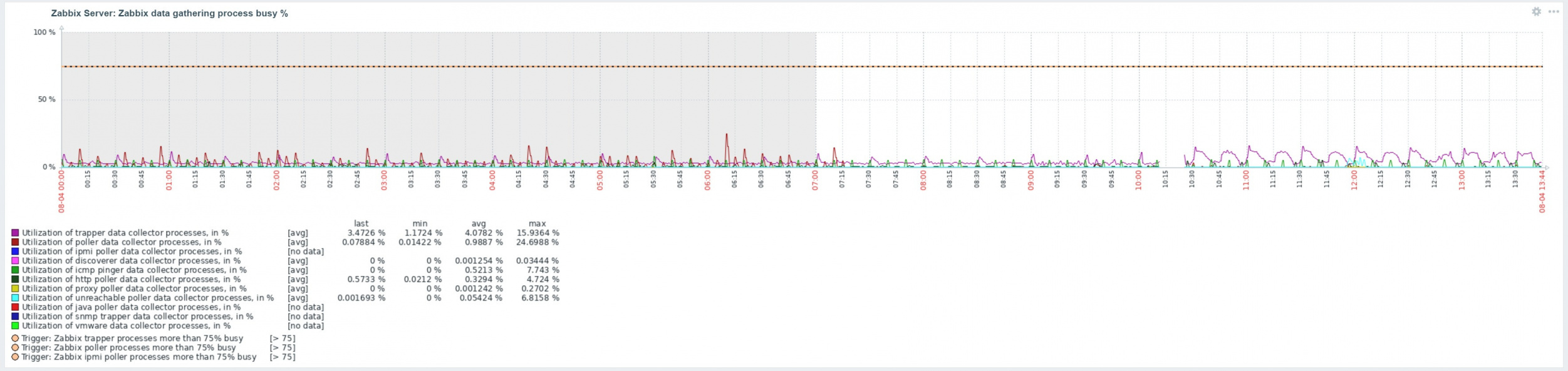

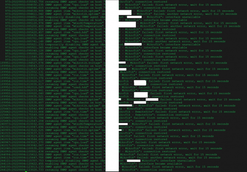

    I uploaded screenshot from zabbix_server.log and pollers graph to attachments.

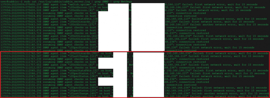

              However, thanks for explanation. I successfully increased logging level for all poller processes (to level 4).
              I see a little more information now. But I am not sure if I understand it. There is 2 images. At first I did snmpget and I received value. At second there is error with parse OID, but its the same item key and same host as the first image.
                When I replaced "string OIDs" with "numeric" in zabbix items, it´s starts work. So I resolved all not supported items from SNMP devices. I thought it should be a problem with SNMP errors in log, but no. Still receive some errors.

                  To understand better, which item fails and what error is thrown, you can grep out all lines for specific pollers based on PID, which is first thing on each log line (in this case 1029, 970, 1044).... Those 4 lines on your second pic are actually from 3 different pollers and only first 2 are connected to each other, 3rd and 4th are not related to first 2..

                    However I disabled bulk request on NetGear switches (switches generated more "first netrowk errors" in log than MikroTik routers) and it was much worse. As you can see at the picture, the red rectangle is after I disabled bulk request. So it´s generated more errors without bulk request. I enabled bulk requests again.
