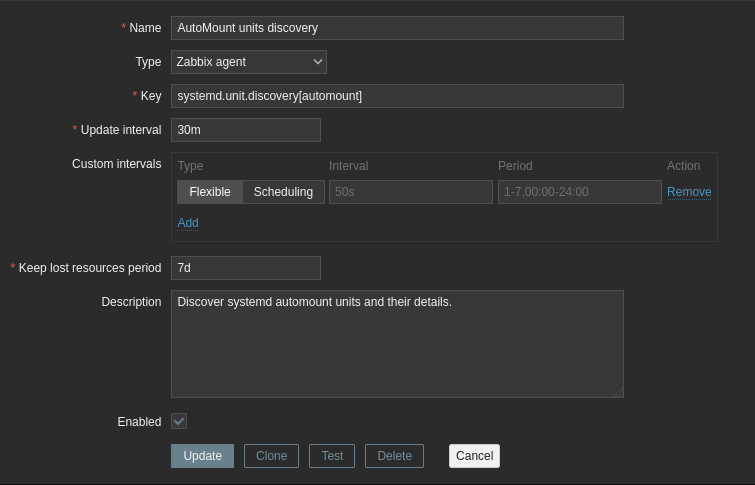

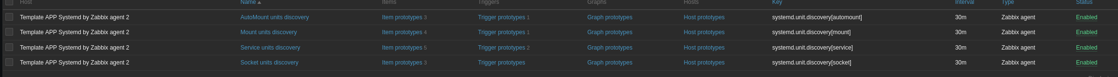

    I added two discoveries to the Systemd by Zabbix Agent 2 template. One for systemd mounts and another for systemd automounts.
    Click image for larger version  Name:	image.png Views:	1 Size:	60.0 KB ID:	450119
    Here's the Systemd mount discovery, the automount is the same except the key is systemd.unit.discovery[automount]:

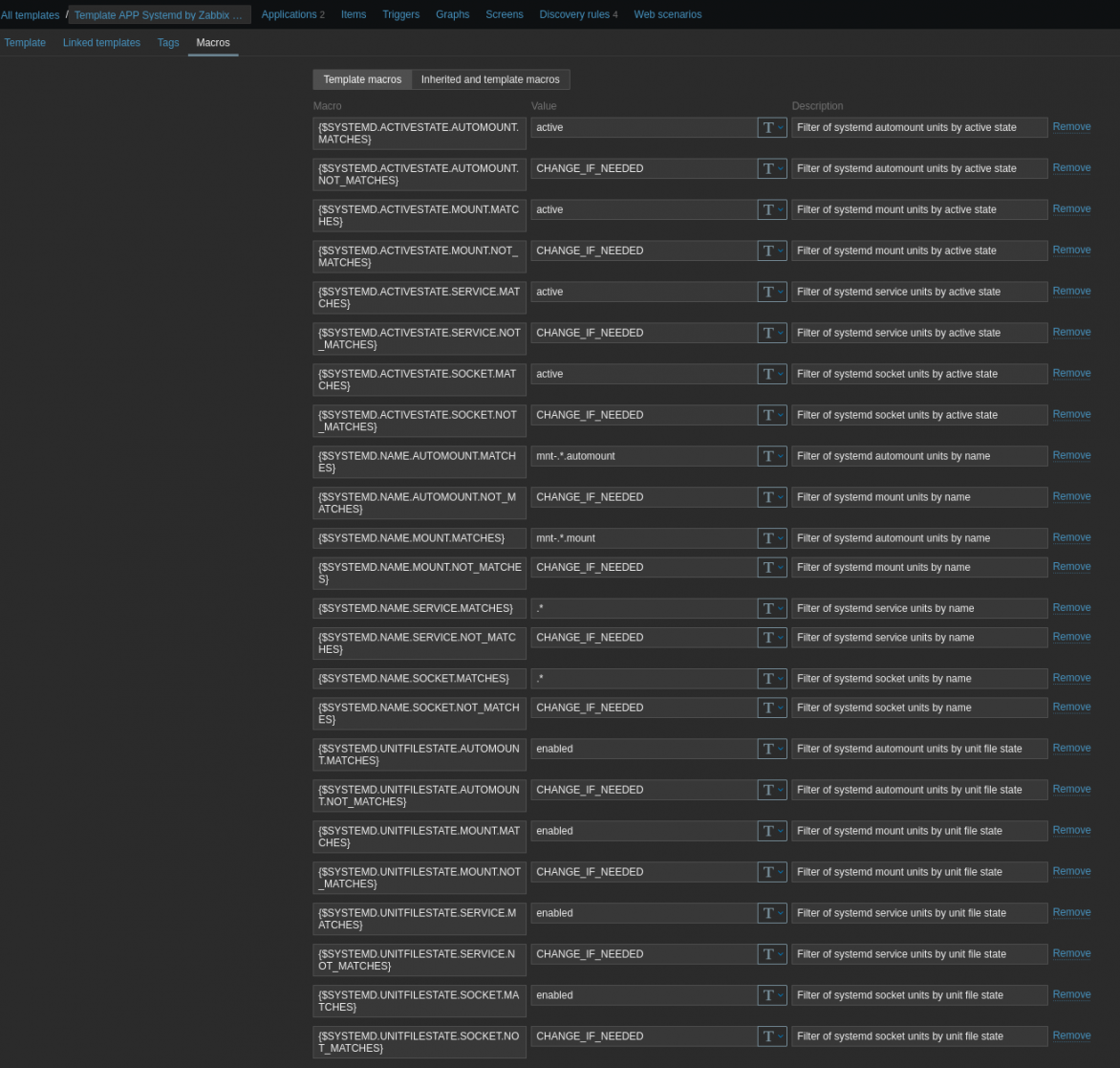

    I also added the appropriate named macros for these in the template and targeted the name for the mount and automount units I want to have discovered (mnt-.*.mount and mnt-.*.automount). Depending on which Linux server you run, there are other systemd mount units created by the system by default that you might not want to monitor. By using the filters mnt- as the start of the filter I'm targeting systemd mounts created by us. This will also set the discovery to only discover the automount or mount service if its set to enabled. So if you only use mount units (without automount), then those will be discovered. If you use automount units in conjuction with mount units, then only the automount units are discovered, since the mounts are not enabled by default, they are triggered to start by the automount unit instead.

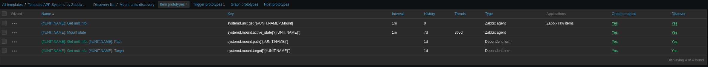

    I then created the following item prototypes in the systemd mount discovery. I did the same for the automount item discovery, targeting the appropriate key. The only difference with the automount one is that it doesn't have a target property so it will only have three items vs the four you see below for the mount units.
    Click image for larger version  Name:	image.png Views:	1 Size:	59.3 KB ID:	450120
    The get unit info item prototype I use to gather some info to display in Zabbix via the dependent items, like the path where the network share is mounted at. On the mount unit I also gather what is being mounted, meaning the Windows share UNC path or the NFS/EFS target. This I do just for informational purposes.
    The item that I use to monitor the actual mount is the Mount state item. Here I'm targetting the key 'systemd.automount.active_state' or 'systemd.mount.active_state'. That key is being populated by two UserParameters I setup on my Linux hosts. These are:

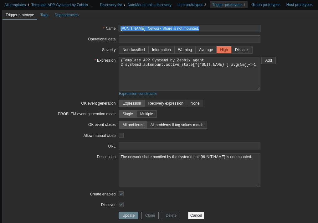

    Now onto the trigger. In our case, we want to be alerted if the value of the active_state item is not 1 for 5 straight minutes.
    Click image for larger version  Name:	image.png Views:	1 Size:	72.1 KB ID:	450121
    We used Chef to deploy the two UserParameter keys to all our Linux systems as an override file in the /etc/zabbix/zabbix_agent2.d folder. So far everything is working great and I learned a great deal in the process. But I wanted to share this for anyone who might be trying to accomplish the same.
