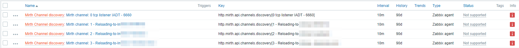

      The Mirth Channel discovery items are being created on the host, but get an error "unknow metric http.mirth.api.channels.discovery"

        I think I have to use 'dependent item' instead of 'zabbix agent' in the 'Item prototypes'.
        It is unclear to me what I need to user as 'Key':

          This key is not unique to I changed it to:
          [CODE]http.mirth.api.channels["{#CHANNEL.QUEUE}"][\CODE]
          But this gives the result below:
          The queue of the channel is 0, so it can retrieve the data but I dont know where to put it

              Right now a new item get created for every channel with the channel name on the host, but the value contains all the JSON data the API returns instead of just the values I need.
