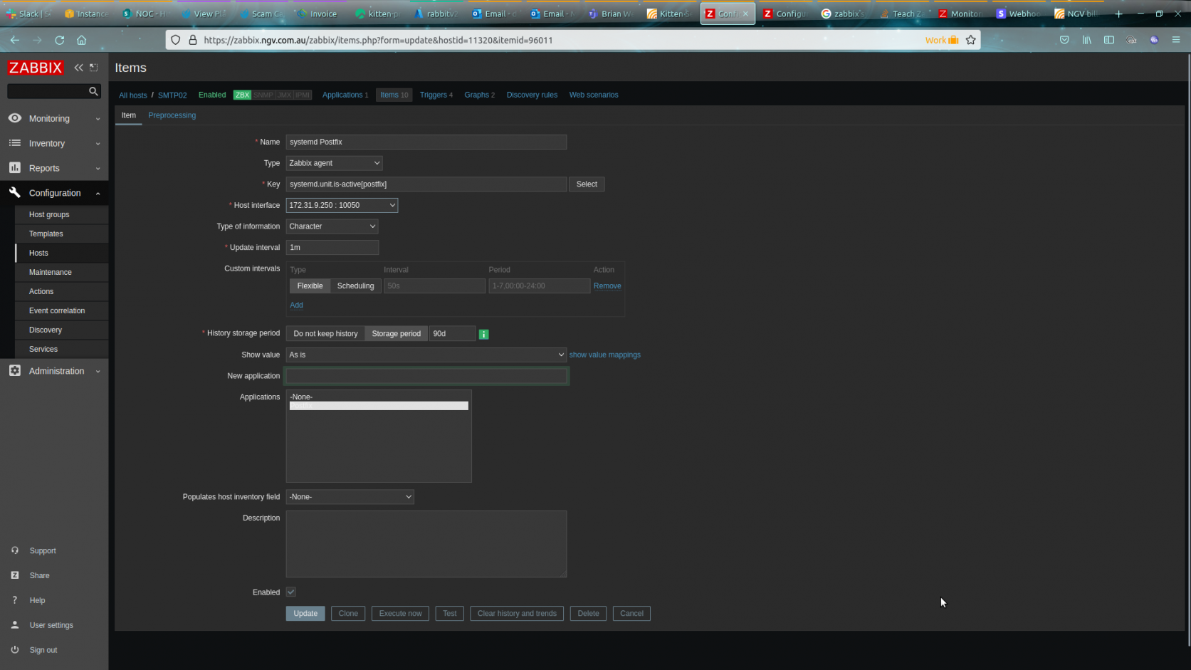

      My item is definitely Zabbix Agent.Click image for larger version

        Your host is disabled. ))
          • 4970
          Maybe because your host is disabled?

            Good catch. I didn't set up that host. Now, the item appears to be in error:Click image for larger version
ID:	449802Click image for larger version
ID:	449803I hope it's in order to post these big screenshots.
