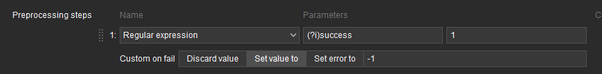

      My main item stores the needed data with the words 'success' or 'failed', then my dependent item preprocess that item looking for the word success and returns a 1 or a -1.
      The problem is the main item is a log type, but I need the depending to be a float due to the negative sign (I want it that way as a 0 would not be different from the times between backups in a graph), or to find another way to show easily the results of my backups (colored).

      For some reason I get this error when the backups fail, the weird thing is that the Type of information is Log in my main item, and Numeric (float) in my dependent... so no Numeric (unsigned) anywhere... but maybe they must be the same type to work.

        I reproduced your situation (zabbix ver 6.2.0) - everything works as it should.
        -1 is recognized as a number, not string
        try using JS preprocessing instead of regex
        return value.search(/success/i) >= 0 ? 1: -1;

          In the end there was no need to change the regex, my master Item was generating an unexpected value as some of the backups are ending with an 'InProgress' status even being OK. That was causing my dependent item to receive a string that it was not able to process.
          Fixed by adding (?i)success|(?i)inprogress to the preprocessing steps.
