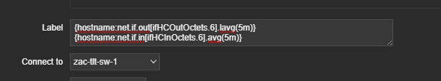

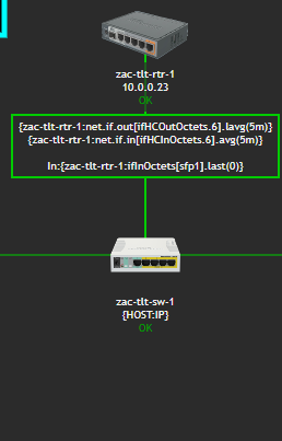

    i have zabbix 6.2 in the link label i put {hostname:net.if.out[ifHCOutOctets.6].lavg(5m)} and {hostname:net.if.in[ifHCInOctets.6].avg(5m)} instead of hostname obviously I have the correct name
    in previous versions if it worked .
    someone could help me.
    zabbix 6.2

    previous versions exactly the same

    I think that since Zabbix 6.0, the way macros are written in labels has changed to match the way functions are written. Please refer to the contents at the following URL.

    I found the solution in case someone has the same problem the equivalent is: {?last(/hostname/net.if.in[ifHCInOctets.6])}
    {?last(/hostname/net.if.out[ifHCOutOctets.6])}
