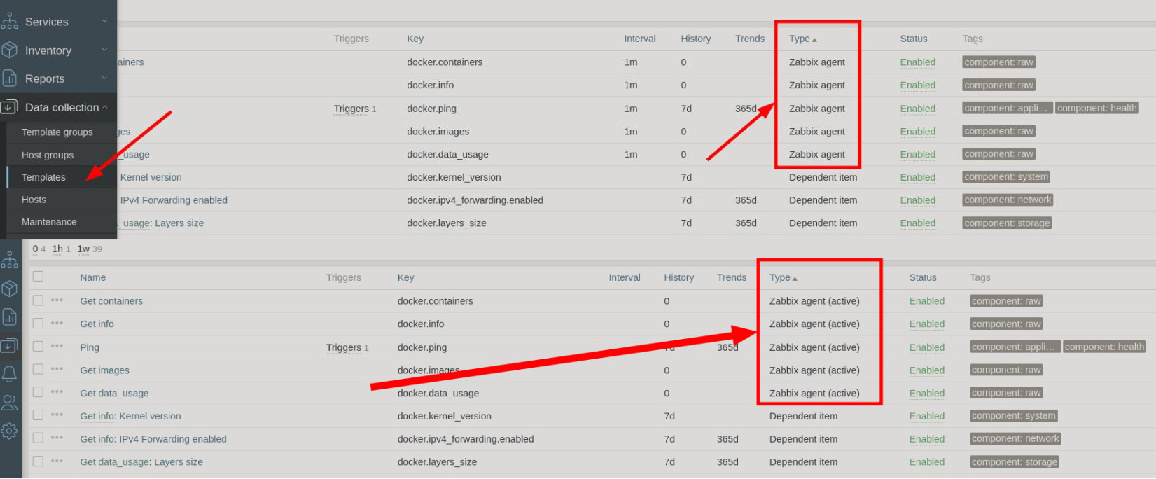

        All the agent items that work as passive, can work also as active... Just change them to active and be done with it...

            Just change the item types (as shown on the screenshot) and do the same for discovery rules. Then the query will be done by the active agent.

              I changed zabbix agent type to active - and it still doesn't work.
              context:
              I have zbx-server and all agents2 in active type. We don't have internal / vpn network so we dont want to open ports in public.
              All hosts works fine in active type. (linux by zabbix agent 2 active temaplate for example )
              When I try to add docker by zabbix agent 2 - It require to add host interface.
              So i add it - public IP and port 10050 (default)
              Now - active metrics works fine - still.
              but Docker by Zabbix agent 2 template don't discover dockers and don't collect metrics.
              Agent have access to docker and I tried to change agent type to active in docker by zabbix agent 2 temaplate like on the up screen shoot.
              Plz help
