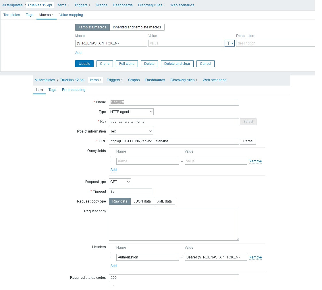

I'm creating (should be) first Zabbix Template for monitoring TrueNas with Api function but I have some problems.
the Github link i'll post when the first release is ready.
My idea is to create an item / trigger for each alert that is not "dismissed" in order to monitor all my Truenas.
Given the notification I connect to the freenas I check what I have to do, and set notification to dismissed true so zabbix at the next check will delete item / trigger
Example of api output

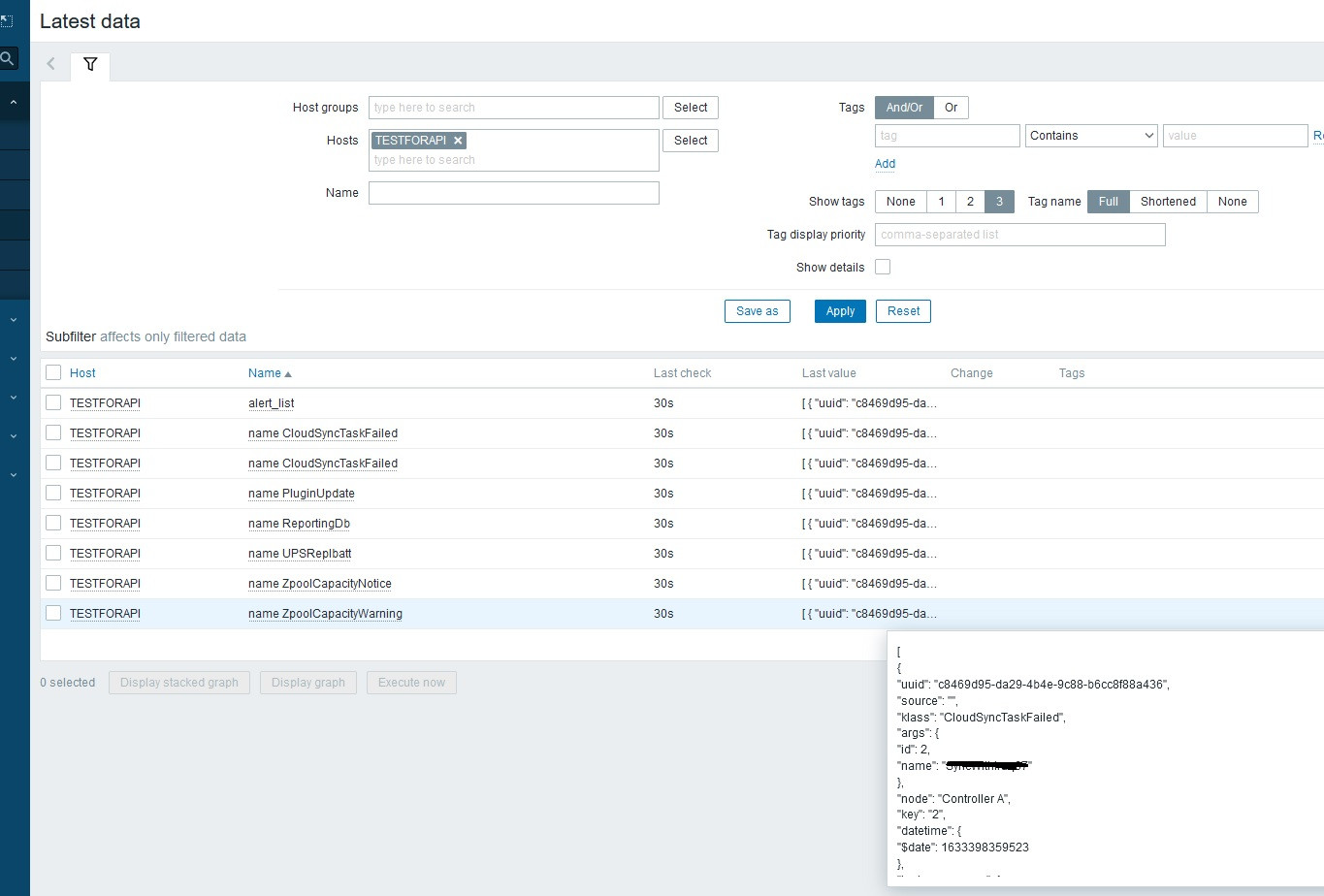

with this Item I'll retrive one array of alerts (both bismissed true and false)
with this "item prototipe" i create one item for each notifications presente in TrueNas
Problem:
1: how to create item only for alter with dismissed = false:
2) for each created item in "value filed" i see all entire json content
