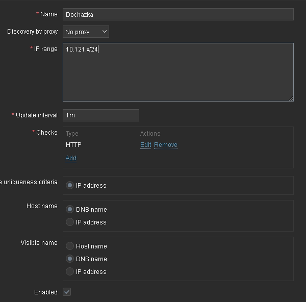

    I have discovery rule like this

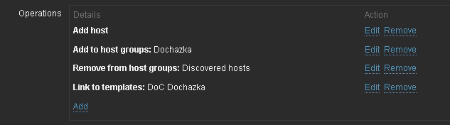

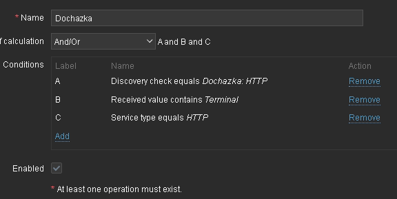

    And discovery action

    So, i guess i'm out of luck on this?
    HTTP check in discovery rule is based on net.tcp.service[] , which does not fetch any data from target host, only opens connection, so i have no data to compare in discovery action condition?
    • Hamardaban
      Hamardaban commented
      Yes - you are absolutely right.
