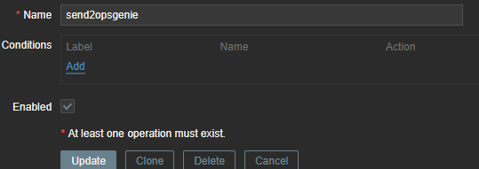

    I'm working on integrating Zabbix (v 5.0.23) with OpsGenie, & defined an action that I need to be run on every event.
    I created the action with "Current host" box ticked and with no condition defined, thinking that would mean it is always triggered - is that right?
    If I run the command manually from command line on the Zabbix server it runs and there are log entries in the OpsGenie part, but on a Zabbix event I'm seeing nothing.
    Wondering if anyone can point me in the right direction? Haven't contacted OpsGenie support yet because I'm not seeing anything happening at all so believe it's an issue in the action configuration.

    I also tried with a condition which should be fulfilled every time just in case it needed at least 1 condition, but sitll no joy. Any pointers appreciated!
