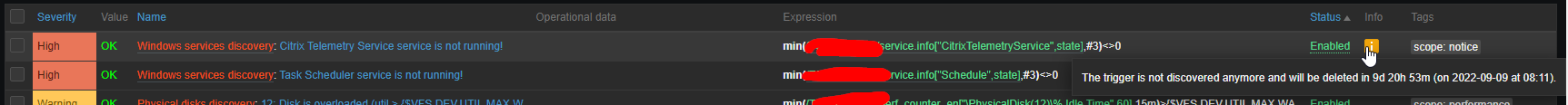

    We have a bunch of servers monitored bij Zabbix 6.2 with the template which discovers services that are started automatically/ automatically delayed.
    Now I wanted to do some specific triggers on 1 server and I click to configure it but all the services says they will be deleted because they aren't discovered
    Although the services are still there and running... and it seems that newly added servers don't properly discover new services.
    The discovery rules are default and if I test the rule it will show all the services.
    Is there something wrong with my configuration why this happens? ​

    I found it, I was just stupid with the config..
    I closed the {$SERVICE.NAME.NOT_MATCHES} with heartbeat|}
    the | at the end just got filled in as all services by zabbix.
