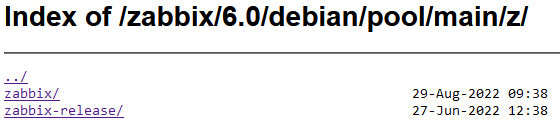

      thank you for your reply. I am still not able to perform the minor upgrade.
      After I use "sudo apt update" and "sudo apt install --only-upgrade 'zabbix-*'"
      I still get:
      zabbix-agent is already the newest version (1:6.0.6-1+debian11).
      zabbix-apache-conf is already the newest version (1:6.0.6-1+debian11).
      zabbix-frontend-php is already the newest version (1:6.0.6-1+debian11).
      zabbix-release is already the newest version (1:6.0-1+debian11).
      zabbix-server-mysql is already the newest version (1:6.0.6-1+debian11).
      zabbix-sql-scripts is already the newest version (1:6.0.6-1+debian11).
      ​When I install the repo it says: "zabbix-release"
      When I look through the repo in the browser there is no newer version under "zabbix-release".
      Only when I go to "zabbix" there are newer files.

          I think I found the error.
          There was no zabbix.list under /etc/apt/sources.list.d anymore.
          I think it should have been added with the wget ... and the dpkg /i ... command. But it didn't.
          So I made a new one and pasted
          deb https://repo.zabbix.com/zabbix/6.0/debian bullseye main
          deb-src https://repo.zabbix.com/zabbix/6.0/debian bullseye main
          ​After that I ran apt update and the command to only upgrade zabbix packages.
          Zabbix is running and it is version 6.0.8.
          Thanks a lot for your help.
