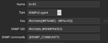

      My LLD looks like:
      discovery[{#IFNAME},IF-MIB::ifName,{#IFALIAS},IF-MIB::ifAlias]
      Then I'm using incoming traffic item:

        Scout, that looks very close to what I need.
        So essentially if I config my LLD like this:
        discovery[{#SNMPVALUE},IF-MIB::ifDescr,{#IFALIAS},IF-MIB::ifAlias]
        And then something like incoming traffic is:
        Would that work?
        One question I have is do I have to create the macro #IFALIAS beforehand or is it automatically created?
        Thanks a lot!!
        • Sponge
          • Mar 2016
          Well, it worked
