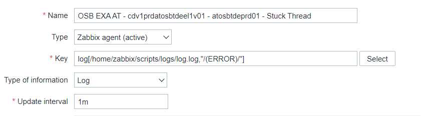

    Hello eveyone this is my first post in this forum and I realy need a help.
    I need to search within a .log document using a regular expression for the term ERROR
    Im using this key log[/home/zabbix/scripts/logs/log.log,"/(ERROR)/"], but it throws me an Unsoported Key error
    Any clue what I'm doing wrong, I have a short time using this tool.
    Thanks in advance

        Try using an expression like this. log[/home/zabbix/scripts/logs/log.log,"ERROR"]​ or log[/home/zabbix/scripts/logs/log.log,"/(ERROR/)"]​
        Check the log access rights of the user on whose behalf the agent is running.
        Check the settings of the Server Active option in the agent config.
        Increase the logging level on the agent and make sure that it receives a list of active checks from the server.
