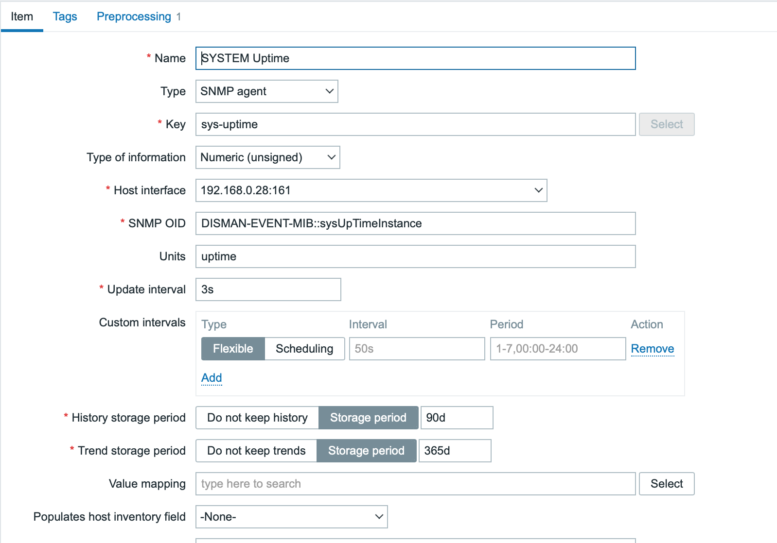

    Hello! I am monitoring a HP LaserJet M15w printer with SNMPv3, however I am having issues when trying to create an item for the system uptime using this OID
    DISMAN-EVENT-MIB::sysUpTimeInstance = Timeticks: (1871274) 5:11:52.74
    However, when setting the up the item as per https://www.zabbix.com/documentation...fig/items/item:
    Special processing is used if the following time-related units are used:
    unixtime - translated to "yyyy.mm.dd hh:mm:ss". To translate correctly, the received value must be a Numeric (unsigned) type of information.
    uptime - translated to "hh:mm:ss" or "N days, hh:mm:ss"
    For example, if you receive the value as 881764 (seconds), it will be displayed as "10 days, 04:56:04"
    s - translated to "yyy mmm ddd hhh mmm sss ms"; parameter is treated as number of seconds.
    For example, if you receive the value as 881764 (seconds), it will be displayed as "10d 4h 56m"​
    I set the item in the following way:
    Click image for larger version  Name:	image.png Views:	0 Size:	138.8 KB ID:	451687

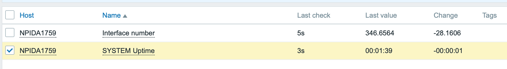

    But I get this value in return:
    Click image for larger version  Name:	image.png Views:	0 Size:	35.9 KB ID:	451688
    NOTE: I did notice that the item preprocessing needed to be set to "Change per second", as per the documentation, but this might actually be the issue?
    Any help would be greatly appreciated!

      Alright, so I'm a dork... the very obvious thing I didn't notice is that the printer is sending back the timeticks through snmp (it was right there under my nose):
      snmpget -v 3 -l authPriv -c set -a MD5 -A authproto -n Jetdirect -u username -x DES -X privctrl -On 192.168.0.28 DISMAN-EVENT-MIB::sysUpTimeInstance
      .1.3.6.1.2.1.1.3.0 = Timeticks: (734008) 2:02:20.08
      And Zabbix actually sees it correctly:
      Click image for larger version  Name:	image.png Views:	0 Size:	127.3 KB ID:	451855
      Now, the deal would be to convert these timeticks into actual time and date. I'm googling some formulas and heck, that sounds difficult! Anyone care to lend a hand on how to achieve this on Zabbix item config? Much appreciated in advance!
      EDIT: Oooohhh, I think I found what I'm looking for! https://www.zabbix.com/forum/zabbix-...cks-conversion
      RESOLUTION: Getting read of the "change per second" preprocessing step and simply adding a multiplier by 0.01 worked!
      Thanks everyone who chipped in.
