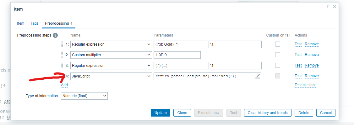

    • EliasHK
      • Oct 2024
      like that Click image for larger version
      original item was LOG , then after preprocess i selected "Numeric" so i can see a graph with increasing value
