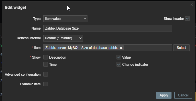

    Once you've done that you can then add a widget to your Dashboard showing the value of your database size.
    Click image for larger version  Name:	image.png Views:	0 Size:	24.2 KB ID:	452436
