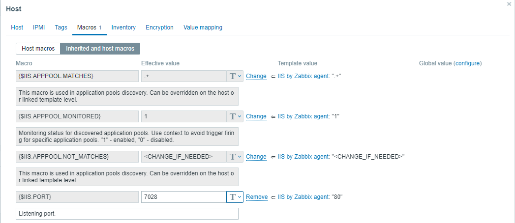

    I've managed to simply change the value of IIS.PORT as on the screenshot and it works. Please go to Configuration -> Hosts.

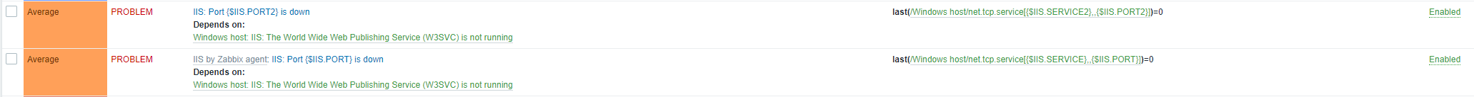

    Clone item "IIS by Zabbix agent: IIS: {$IIS.PORT} port ping" and change the key to the proper macros.
    Then clone trigger "IIS by Zabbix agent: IIS: Port {$IIS.PORT} is down" and change the expression.
    ​​​Click image for larger version
    Works in Zabbix 6.0.
    This is how generated alarms will look like.
