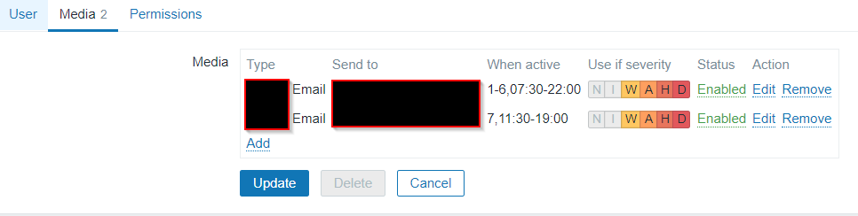

    Getting notifications all night long ...
    Zabbix 6.2, Ubuntu 22.04 -
    Even though I have set this I still get emails all night long. Any idea on how to fix? The clock on the zabbix server is correct, and I took the below to mean that zabbix would only send emails during my active times.
    Click image for larger version  Name:	image.png Views:	0 Size:	20.2 KB ID:	452892​

    Mail Settings seems correct, Looks likes mails are being triggered from other users media. Have you verified actions logs?

      I know it is frustrating, can't figure out why it is sending all night long, I have disabled all other media types, triple checked the process. I am sure I am missing something (obviously) but I can't find it...

        How are your timezones configured on the server and in Zabbix server?

          Took me a minute to figure out what you meant by that Markku as Zabbix was showing the correct time on the dashboard. However the server itself had an incorrect time...
          I fixed that with the following command
          sudo timedatectl set-timezone America/Chicago
          Now it is wait and see...
