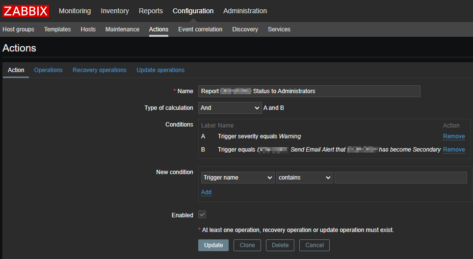

    ​Under Configuration > Actions, I created an action as below. Gave it a name, said A and B must be true, set the conditions to "Trigger severity equals Warning' and 'Trigger equals <trigger name>'

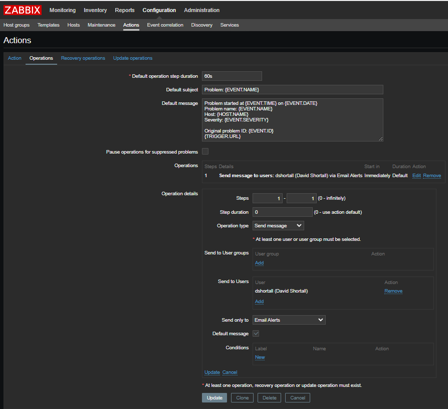

    Under Operations tab​​, I configured the below. Default message recurring every 60 seconds, sending a message to my own user account, using the media type 'Email Alerts'.
