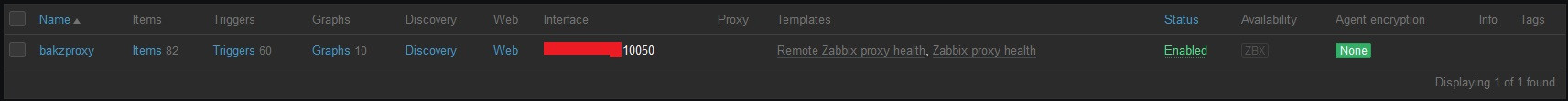

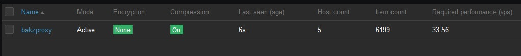

                        • bab
                          • Aug 2020
                          • 197
                          I think there are not any issue for zabbix proxy in GUI . I have added zabbix proxy in gui and there are not any issue
                          please see attached pic
                          • Markku
                            • Sep 2018
                            • 1784
                            I was not asking you to fix a proxy.
                            Go to Configuration - Hosts, go to the host named "bakzproxy" and fix it to use the "10.10.10.100" proxy.

                            • bab
                              • Aug 2020
                              • 197
                              #15
                              Markku
                              It has been added previously
