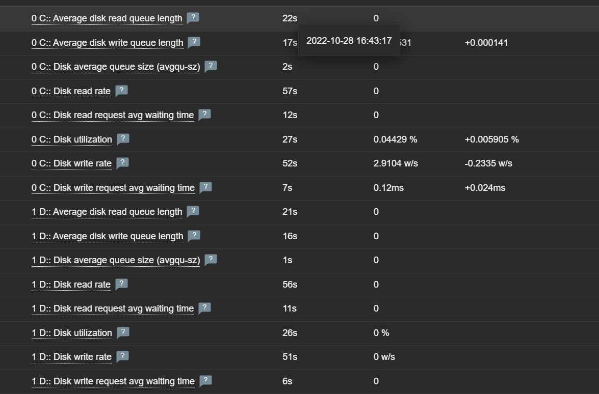

        As you can see, I receive Data from the agent which is installed on the windows machine:
        Also if I use the same directory but a different folder and copy ~ 100 XML files to it, it works...
        I dont know why it should not work.
        Best regards and a nice weekend!​
