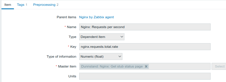

    I have nginx installed on my web server. I have installed the Nginx by zabbix agent.
    I see the following when I look at the config.
    My site is up and running, only I have a forced https redirect in my config. How can I get zabbix to accept and follow the redirect?

      You are showing us "dependent items". Those are just reporting that they cannot extract data based on regex from your main item. Is "Follow redirects" checked in your main item config ("Nginx:Get stub status page")?

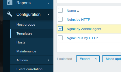

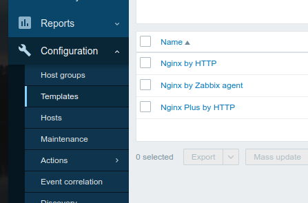

              Thanks for responding. After updating the template directly I am now happy that it is working.
              I did the following.
              Under Configuration / Hosts / Templates I selected the template Nginx by Zabbix agent
              Select Triggers and then the item named Nginx: Failed to fetch stub status
              When this opens you can then edit and change the expected HTTP code.
              The default setting is 200, I changed it to 301 to reflect the redirect. That solved my issue.

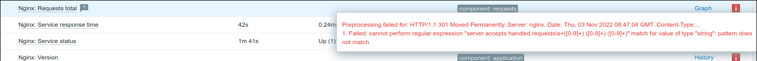

                  I don't really have an understanding of what the template does or expects to do.
                  Looking at it now, the stubs parts is working but none of the others are.
                  Looking at total requests and requests per second. Both of these depend on get stubs status, but the requests are failing..

                  So it seems fixing one thing does not cascade to fixing the dependancies.
                  Any advice.
