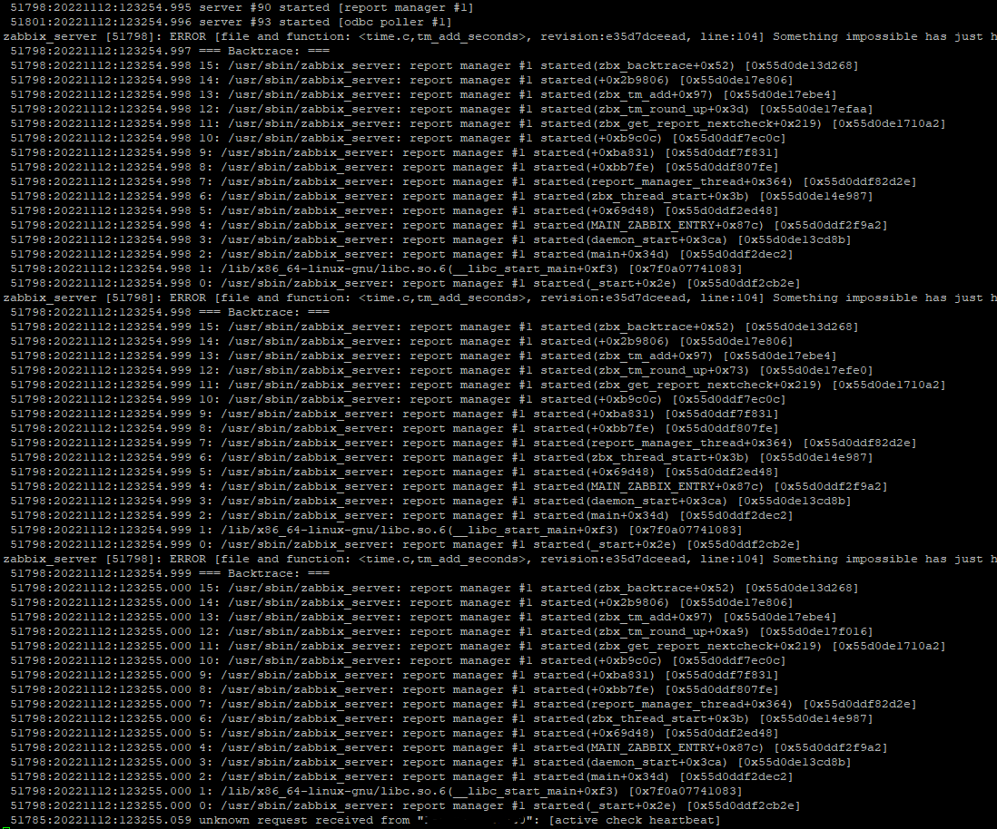

    Update on this:
    - upgraded to Zabbix to 6.0.10, updated tables - same thing,
    - set up new Ubuntu 22.04 LTS instance, clean installed MariaDB, Zabbix 6.0.10, migrated database and config - same thing,
    - removed my Scheduled Reports - report manager starts fine,
    - created scheduled report again - report manager starts, it still logged crash twice, then finally started.
    It seems like issue with Zabbix running on latest Ubuntu (no idea about other versions).

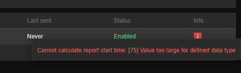

    Besides my report I can see:
    • marcinch
      • Nov 2022
      Issue seems resolved:
      - updated timezones in OS and php.ini file to match Zabbix
      Info about time calculation error is gone, so is report manager crash no more in the log after restarting Zabbix server.
