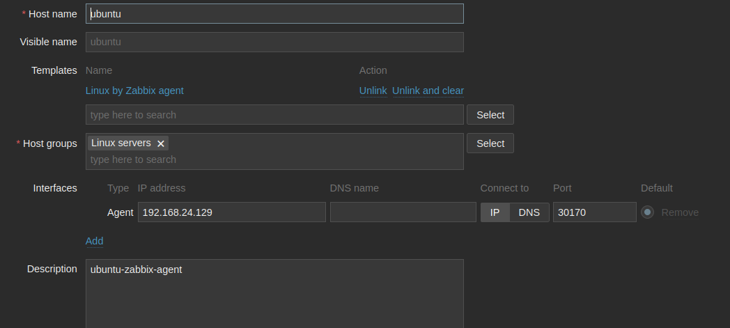

    In the server dashboard, the host has been added with the following features:
