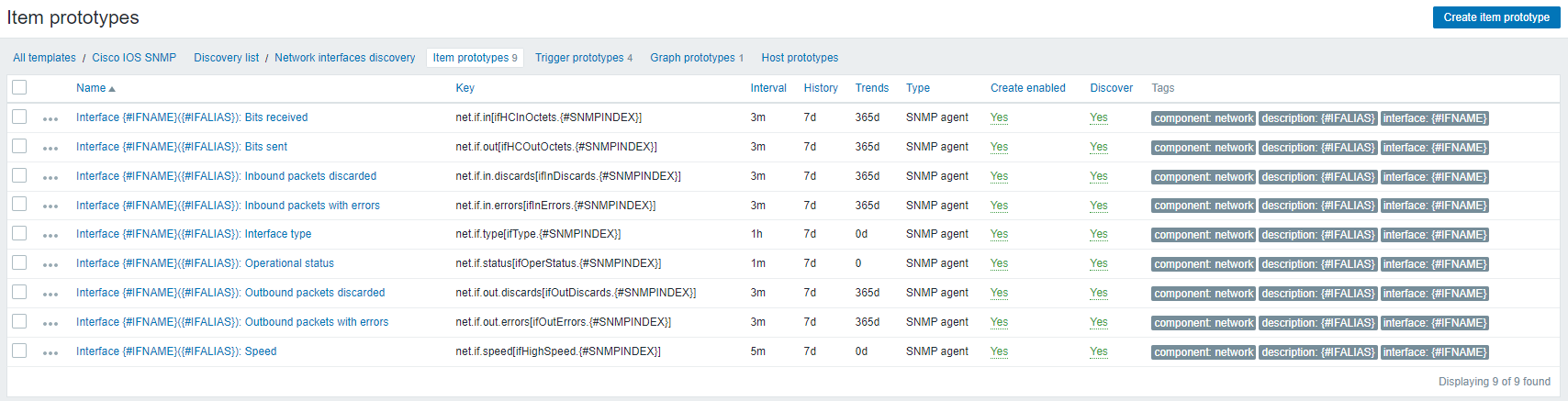

      ​Hi, go to Configuration | Template and open the template you use to monitor your Cisco routers via SNMP. Since Zabbix has to discover which ports are available on your routers you'll find the port related monitoring items under 'Discovery rules'. To show you I have opened the template "Cisco IOS SNMP" which comes with Zabbix.

      If you open 'Network interfaces discovery' you can click on 'Item prototypes':
      Here you'll find all items that are created for each interface that Zabbix discovers. Here you can also update the interval in which Zabbix is supposed to poll these metrics.
      Here it is 9 items per interface. So, if you have a router with 3 interface Zabbix will create 27 items in total to monitor the interfaces.
      Keep in mind that changes to the item prototypes do not take effect immediately. The next time Zabbix discovers the interfaces it will update the items according to the changes made to the item prototypes.
