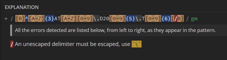

                            • 5002
                            #15
                            Originally posted by omar.cacciotti
                            It seems that it doesn't work again in Zabbix 7.0
                            This regex is valid but not working
                            [B]^[A-Z]{3}AT[A-Z][0-9]\.D20[0-9]{5}\.T[0-9]{6}[/B]
                            I'm trying to double backslash the dot
                            Not valid as it seems... but has nothing to do with escaping dots...
                            • omar.cacciotti
                              omar.cacciotti commented
                              Sorry I didn't see and .. it is a refuse. I suppose a copy/past error.
                              The regex is ^[A-Z]{3}AT[A-Z][0-9]\.D20[0-9]{5}\.T[0-9]{6}
                              But i had to double backslash the dot to get it working correctly. With a single \ it raise an error
                            • omar.cacciotti
                              Sorry I didn't see
                               [B] and [/B]
                              during my answer .. it is a refuse. I suppose a copy/past error.
