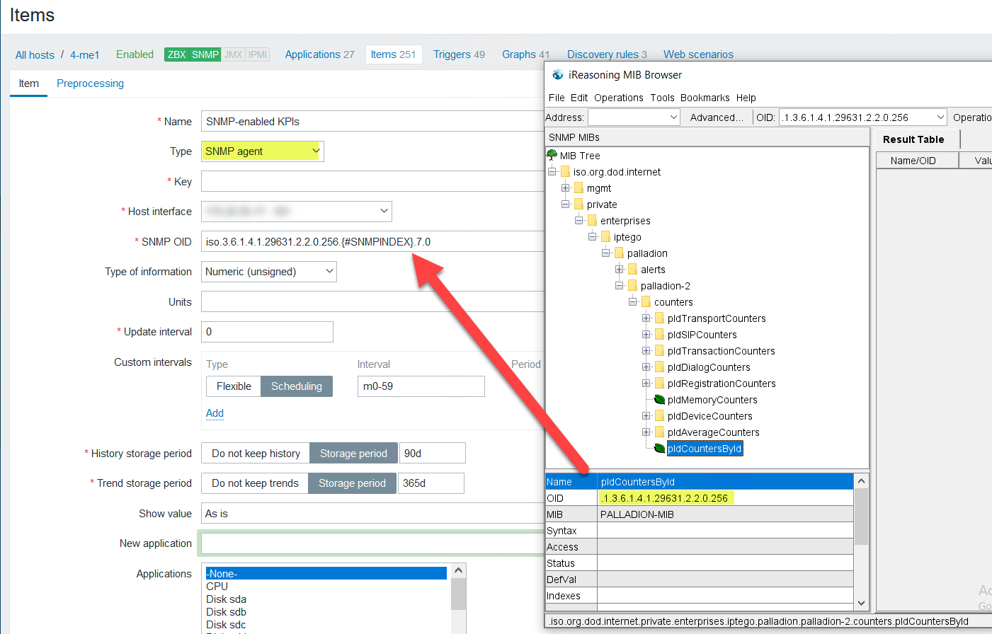

    Hi Team,
    I am new to Zabbix and I need your kind support.
    I have a device connected to Zabbix server and want to create items automatically in Zabbix server for any SNMP-enabled Items which start with .1.3.6.1.4.1.29631.2.2.0.256.xxxx
    as shown in the attached snapshots.

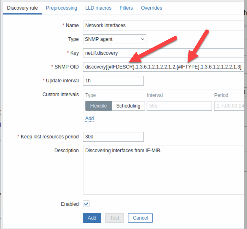

    It seems your best bet is to use Discovery of SNMP OIDs.

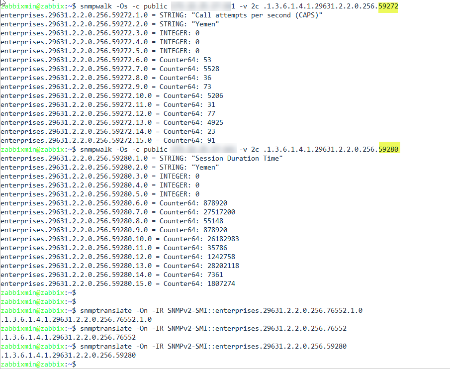

        I'm unable to reproduce the same items you have.
        Reading from your OIDs, I believe your discovery item would be something like this:
        discovery[{#CAPS},1.3.6.1.4.1.29631.2.2.0.256.59272,{#SESSION_TIME},1.3.6.1.4.1.29631.2.2.0.256.59280]
        It is pretty much a Key,value pair.
        The resulting entities are a JSON structure which you can use to create item prototypes.
        Test it out over there and post the results.

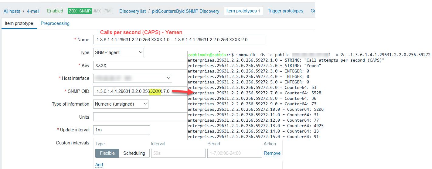

          I have tested your concept and it is good for two items (59272 & 59280) but the problem is that ,there are a lot of items (more than 1000 items) in the 1.3.6.1.4.1.29631.2.2.0.256.xxxx.
          and I want the items name to be generated from 1.3.6.1.4.1.29631.2.2.0.256.xxxx.1.0 and the SNMP OID value to be generated from 1.3.6.1.4.1.29631.2.2.0.256.xxxx.7.0
          so how is the discovery rule going to be?. your kind cooperation is highly appreciated.​

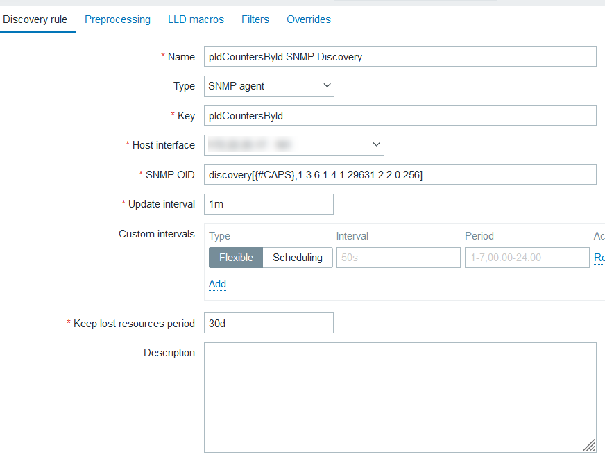

            Does XXXX mean a sequence bigger than 1000?
            Zabbix documentation says that "the discovered entities are grouped by {#SNMPINDEX} macro value".
            What I understand from SNMP LLD is that the index is sort of appended to the end of an OID.
            Therefore, it can only "walk" the provided OID subtree.
            I guess it is not possible to change part of the OID besides the index itself.
            If you remove the last number from your discovery, stopping at 256, you would find all values under it.
            Considering the amount of values for XXXX and the previous SNMPWalk you attached, that would give 15 * XXXX. That could be a big JSON.
            Under those values, you can try to use JSONPath to extract the required "name" and "value".
            Try it out and show us the result.

              I used the SNMP OID discovery[{#CAPS},1.3.6.1.4.1.29631.2.2.0.256] and got a very big JSON as you expected. Then I tried a lot to use JSONPath to extract the required "name" and "value" but I couldn't get any result.

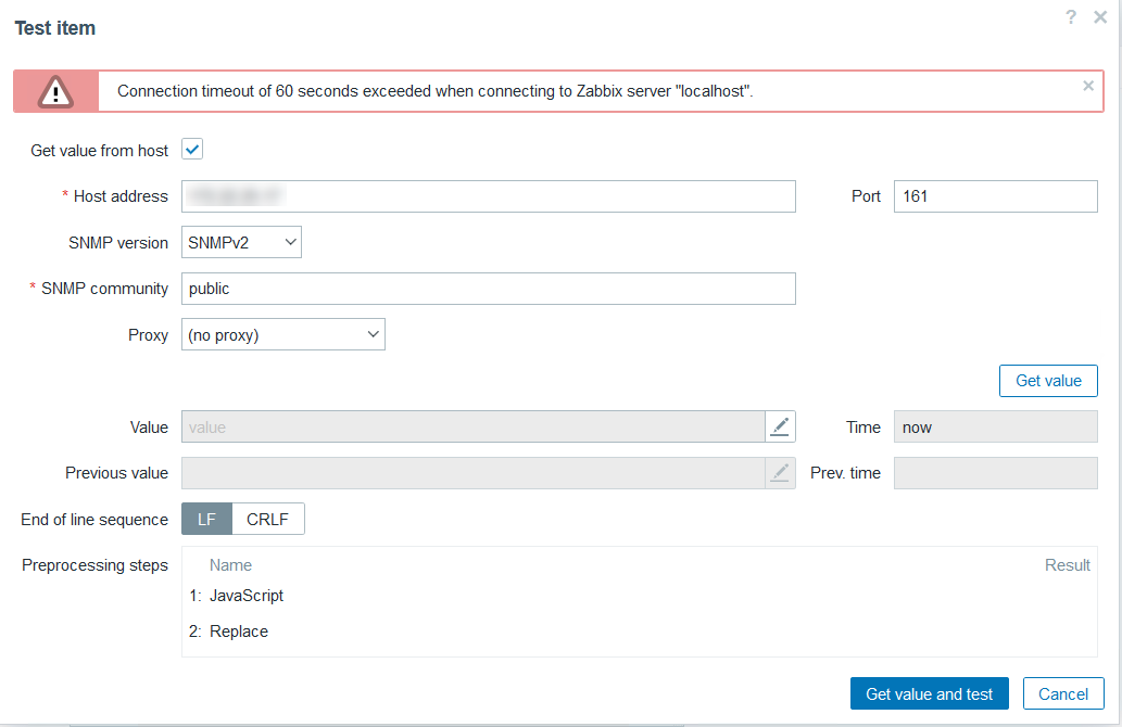

                  please note that the discovery has been created successfully. However, for some snmp OIDs where there are many objects, I got a connection timeout error as in the attached snapshot.
                  please your kind help to overcome this issue.

                      After creating your discovery item, try to test it with the frontend test option.
                      It should display the raw JSON.
                      Save that data to a file, then use JQ tool to test your JSONPath filter.
