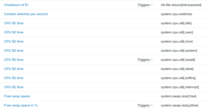

    I just upgraded our old Zabbix 4.4 to 6.0 and now I am (of course) having issues with templates, probably due to updates to templates or something.
    For example, I have template "Template OS Linux", which provide items such as these:
    Only now some of the items' names refer to some variable ($1 or $2). However, the item itself refers to correct value in system.cpu.util, idle/user/nice/ and so on. Some of the items look normal even though they seem to be of same format as those that don't:
    That syntax (positional macros) was deprecated 4.0 and it was removed in 6.0: https://www.zabbix.com/documentation...nger-supported
    You need to manually fix the template that uses those, like: "CPU idle time" and so on (in some templates they may refer to LLD macros like {#FSNAME}). Basically the number $N refers to the Nth parameter of the item key.
