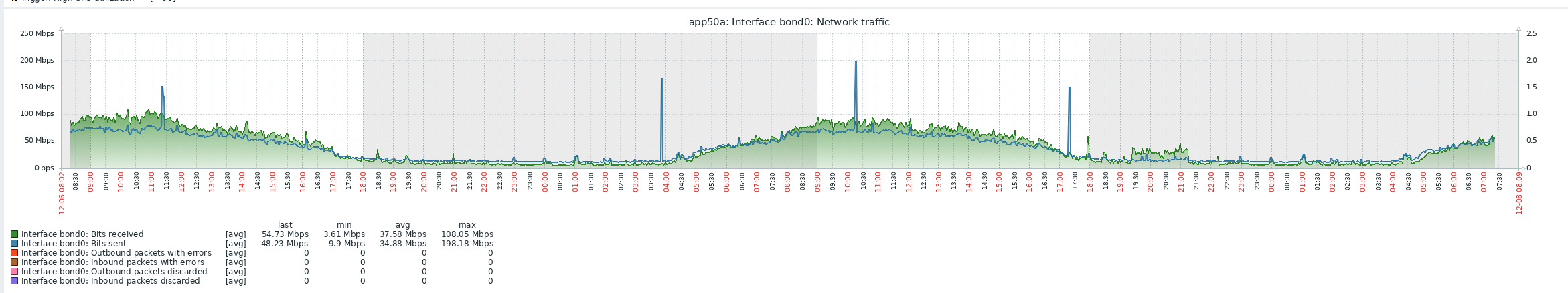

    Lol, now I feel stupid. I never noticed that the date range in the upper right was defaulting to: 12/6 - 12/6. I assumed it would always default to today. I changed it to: 12/6 - 12/8 and now I see data in the main graph.

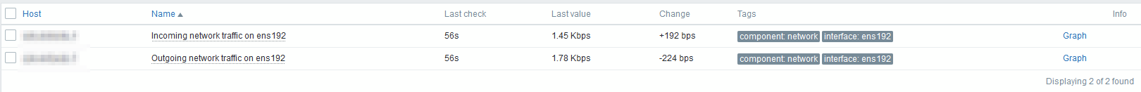

      What is the network interface name that you use on the RL server? What does the latest values look like? For example here:

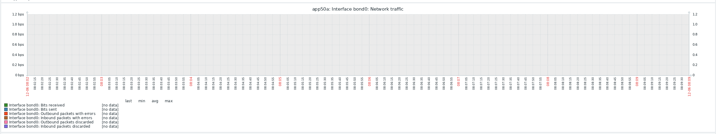

        The main graph shows no data for bond0...

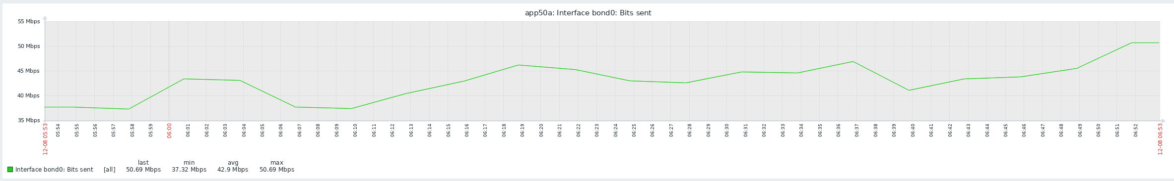

        And if I click the Graph button to the right of (for example) Bits sent, that also looks correct.

          When did you start collecting data? The "Bits sent" graph is from today but the "Network traffic" graph is from two days ago. Should it have any data there?

              Can you show the Bits sent and Network traffic graphs from the same timespan?
