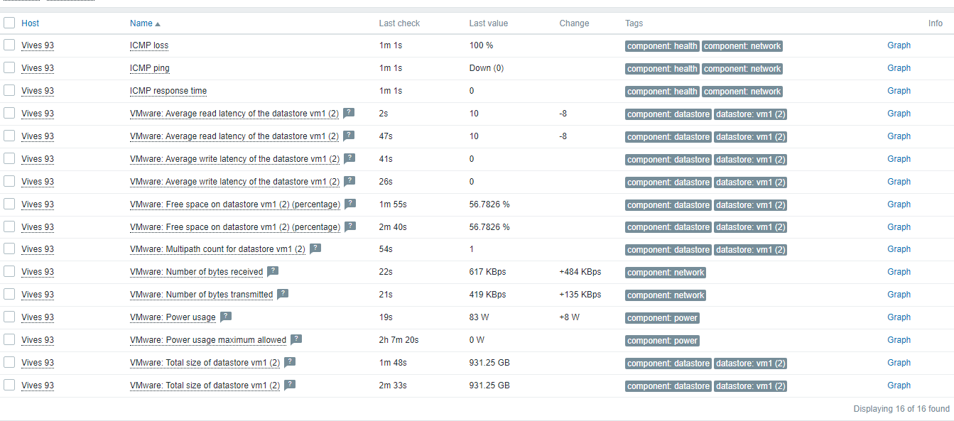

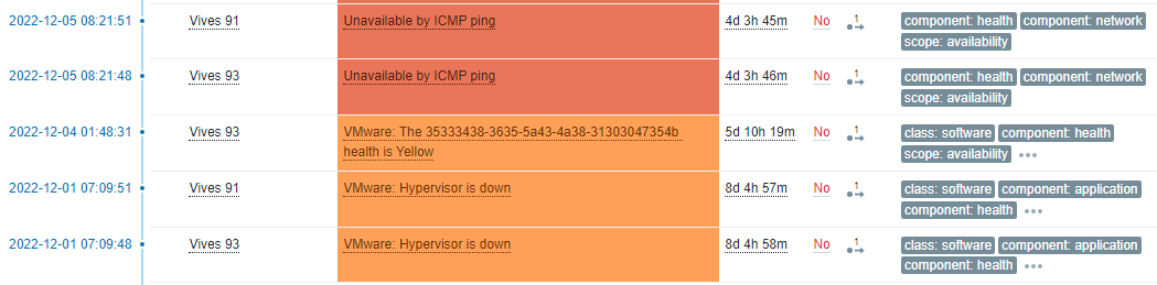

    Hi guys:
    As described my problem is:
    Zabbix 6.0.11 is reporting my hypervisors is down but it isnt, it collects perfectly other metrics.
    The hypervisor is monitored by a remote proxy (6.0.11), fresh install (ubuntu 22.04), fping permissions and path in the proxy are correct.
    From the proxy i can ping the hypervisor and its VMs.
    Im kinda lost since i have 4 others proxies which i installed the same way and work perfectly.
    Any suggestions would be apreciated.

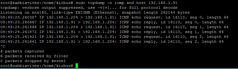

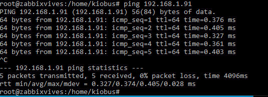

      Hi Markku, logs seem correct as they not say anything about icmp ping, they just say started icmp pinger which i think is normal behaivour,
      Regarding tcp dump also seems fine while pinging hypervisor from proxy (check screenshots).

        So do you mean that your own manual pings are shown in tcpdump, but not the pings that the Zabbix proxy should do?
        Markku
        • javiers
          • Oct 2022
          • 18
          Yes, thanks Markku for your fast reply, manual pings are shown but nothing else, if i stop manual pinging tcpdump does not capture anything.

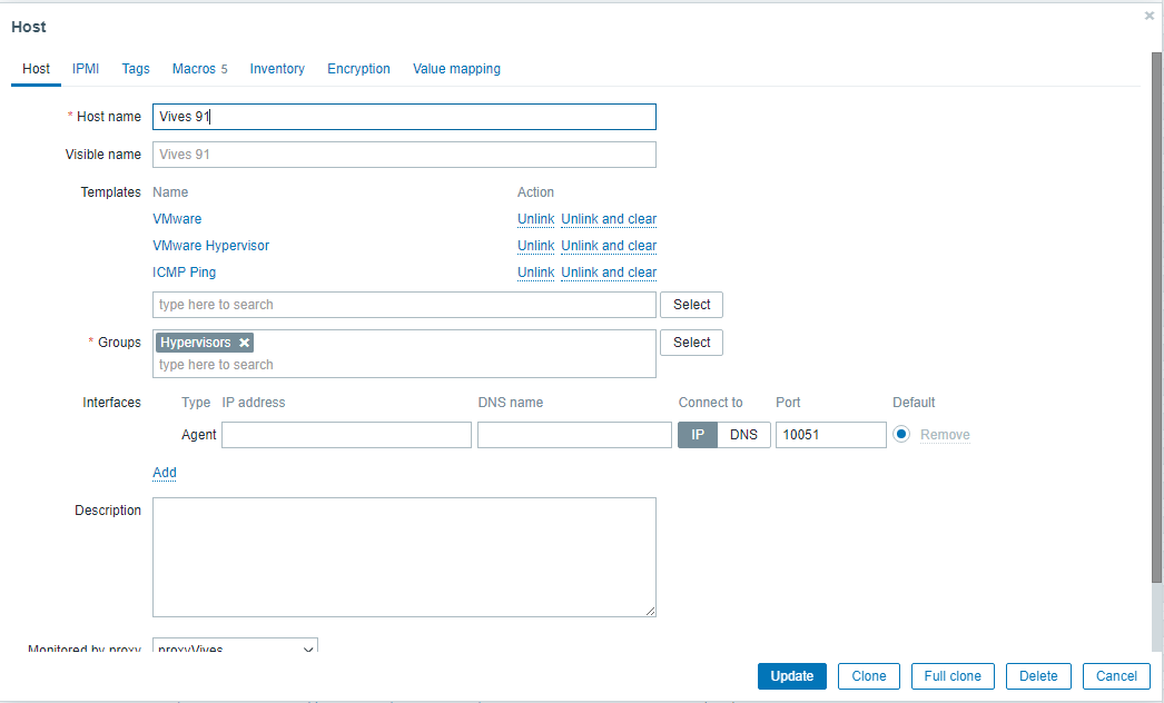

            How is the host interface configured for Vives 91 in Zabbix?

                Since the icmp wasnt working after fresh install, i did some research and people on similar posts were asking to check for fping permissions and its location so i just assumed something had to be wrong.
                In zabbix host interface is configured the same way i have all my other hypervisors which work perfectly:​

                  The VMware items don't use the configured host interface at all. They use the macros that specify what is the URL to the host or vCenter. Right?
                  In contrast, the ICMP ping item uses the host interface configuration to find out what is the IP address or DNS name to ping.
                  If the host interface IP address/DNS name is missing or is incorrect, your VMware items will work but ICMP ping items won't.
                  Now, I asked you how the host interface was configured, and you showed me a screen where there is no IP address or DNS name at all. We already know (based on your earlier posts) that the IP address of the host is 192.168.1.91. Did you remove it from the screenshot or is your host incorrectly configured?

                    Yes i did remove the ip address, but yes, it points to my hypervisor 192.168.1.91 which runs esxi 6.7

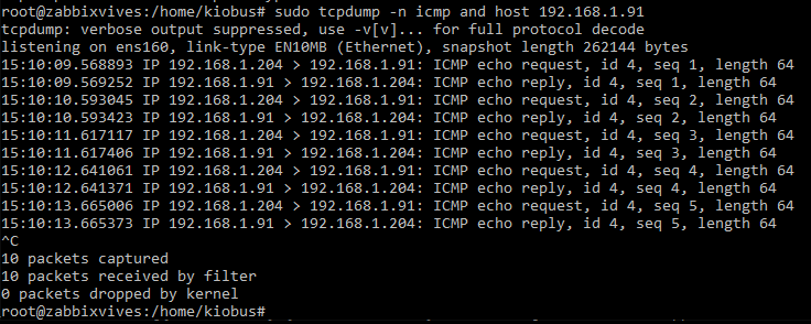

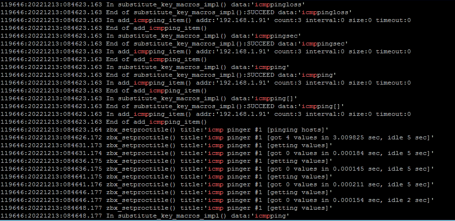

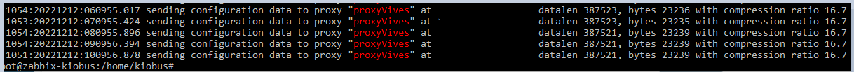

                            Hi markku, after using debug level 5 i could find out that the ip which was beeing pinged was wrong, maybe because i misstyped it the first time i added the host to zabbix and it didn't update for whatever reason, so i removed the host and readded the host with the correct ip.
                            Sadly, even on the new host, frontend still shows down, the only part that has started working now is the tcp dump you suggested a couple of replies ago, ill add the tcp dump screenshot as well as the log from the proxy about the icmp ping.

                              #15
                              Some progress that is! For me it looks like the pinger got the responses ok (three pings, one second apart as described in https://www.zabbix.com/documentation...cks#icmp-pings.
                              In your screenshot there were three normal items: icmpping, icmppingloss and icmppingsec. But the fourth is icmpping[]. What is that item?
