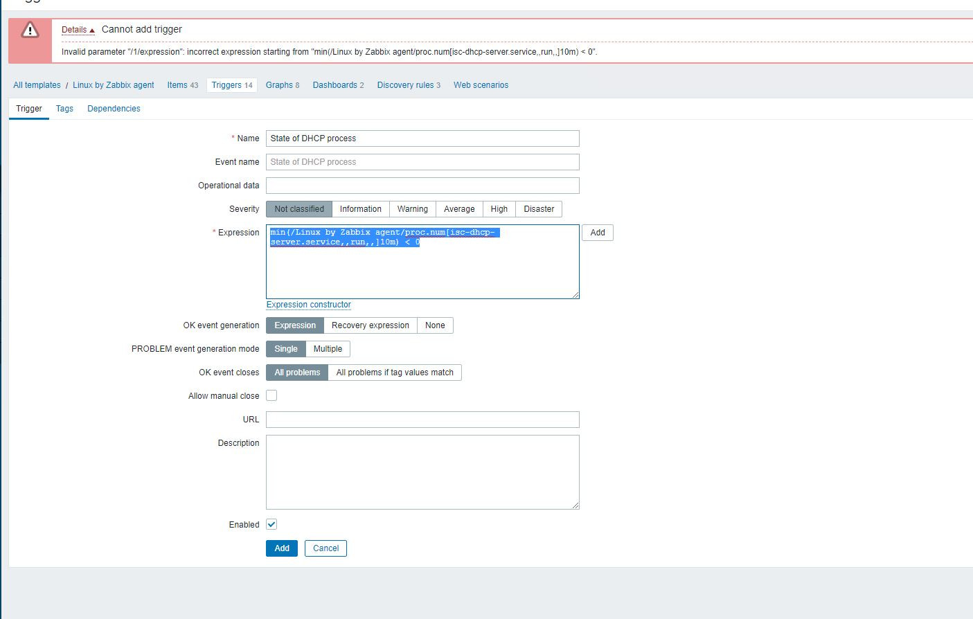

    I am trying to monitor the dhcp service running on two of my linux server. I created a new item and used the key "proc.num[<name>,<user>,<state>,<cmdline>,<zone>]​" after that I tried creating a trigger and that is where I ran into a problem.
    Here is the expression for the trigger
    func(/Linux by Zabbix agent/proc.num[isc-dhcp-server,,run,,])=0
    Error:
    • Invalid parameter "/1/expression": unknown function "func".
    ​When I changed the function to min and add ",15m"
    min(/Linux by Zabbix agent/proc.num[isc-dhcp-server,,run,,],15m)=0
    Error:
    • Incorrect item key "proc.num[isc-dhcp-server,,run,,]" provided for trigger expression on "Linux by Zabbix agent".
    My goal is to be alerted when the DHCP service is not running.

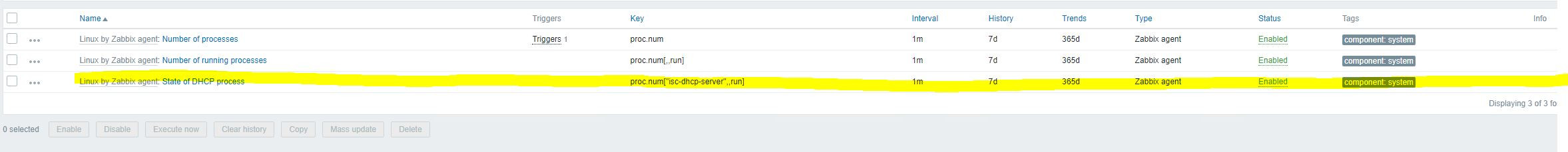

      I have an item created with key "proc.num["isc-dhcp-server",,run]"
      I click to create a trigger where the 3 dots are.
        vs.
        They are not the same, hence your "Incorrect item key" error.

          Okay I fixed it here is the change I made,
          min(/server/proc.num["isc-dhcp-server",,run],5m) <= 0
          Does this mean that if the service is not running for more than 5 mins I will get an alert for it?
