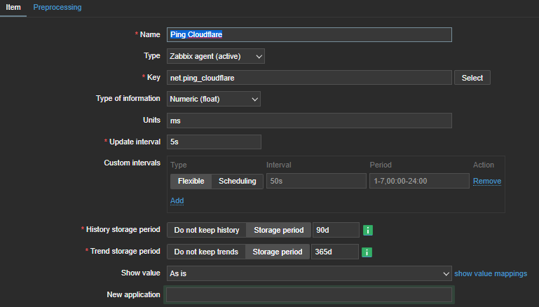

    • lbon
      • Dec 2022
      • 14
      Originally posted by Markku
      How is your item configured?
      Markku
      Like this:
      • Markku
        • Sep 2018
        • 1786
        You are using 5s interval which is quite unusual for Zabbix items.
        How is your agent configured?
        Anyway, I already suggested you how to investigate the agent so there is that.
        Markku
