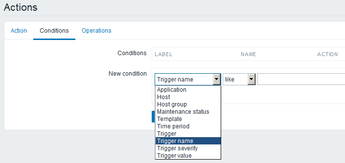

    I'm currently setting up Zabbix and have discovered my first problem: I installed the Zabbix Agent on a Windows 7 test client. Then I've set up a discovery rule for all clients in our network.
    Next step in the documentation would be to define an action with the following details:
    Unfortunately, when I go to Configuration > Actions > Create Action > Conditions, my options look like the screenshot attached to this posting. As you can see, I lack the options 'Recieved value', 'Discovery status', 'Service type' and 'Uptime/Downtime'.
    Without these options, I'm obviously not able to recreate the action mentioned in the documentation.
    I'm sure this is just an error by me, maybe someone can point me in the right direction.
    Cheers, Lomo.

    There are 4 different action types, you are in the Trigger type, you need to be in Auto registration, look at the upper right part of the screen.
