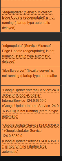

          I am trying to get rid of the service monitoring.. It is simple as disabling "windows service discovery" in the template, but I am not getting rid of the existing alerts for services.
          I wonder what is the correct flow to clean them up? I understand that I have to change the "Keep lost resources period" to a low value, but I disabled the item completely. Does it need to be enabled in order to clean the existing items?

          Click image for larger version  Name:	image.png Views:	0 Size:	25.5 KB ID:	481979
