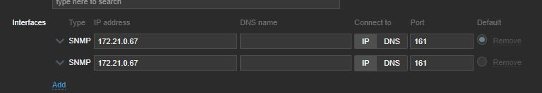

    After migration from 4.4 to 6.0
    Hi, we did migrate our Zabbix server from 4.4 to 6.0 and since, 2 SNMP interface appear in hosts definition, and the second one cannot be deleted, any solution?

    I think if Remove isn't allowed, some item refers to the host interface. Since they are identical, I think you'll have to change one IP to find what item is referring to the 2nd interface. You could also use the API to get the interface id's and match up with the items. Did it occur on all hosts? If just some, see what is common.

      Thanks for the answer, yes it occur on all hosts. I guess I'll have to clone and reconfigure all hosts

        How many hosts? Do they use templates? One or more templates per host? Is having 2 interfaces enough of a problem to redefine all hosts?
        The trick of changing the IP on one interface on one host might tell you if it's only one item or many on each host.

          Guys, I foud a olution on this page: https://support.zabbix.com/browse/ZBX-18258
