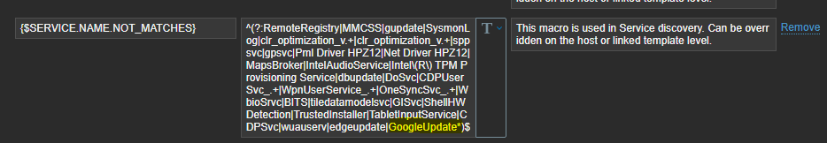

          • speedtre
            • Mar 2024
            Originally posted by cyber
            Without wildcards it will look for exact match, not partial. So, yes. you need to use wildcards... * means "zero or more of previous"... so you should use ".*"
            I'm trying to get it sto stop reporting that GoogleUpdater is not running. Google Update has different versions depending on the version on the machine, (i.e. "GoogleUpdaterService124.0.6342.2") so I'm trying to get it to stop reporting on all versions. I can get it to stop reporting on a specific version if I include the name of the version, but only that version. I've tried the * wildcard (at the end), but it's not working....any ideas?
              You quoted my post, where is the answer...
              I'll repeat
