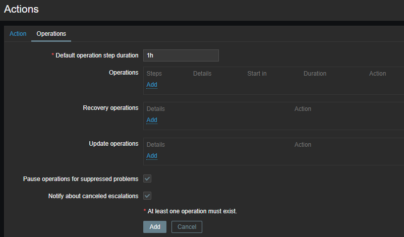

    For the proxy, we have a trigger configured that reports immediately that there is no connection to the proxy.
    Trigger
    I found in the Actions menu, the ability to set an action for the Trigger, so that when a problem occurs, there is an opportunity to perform certain actions. At the same time, there is the possibility to use created scripts.
    However, I am not sure if it is possible to create a script that updates the values of a host or a hosts group.
    When scripting here, should the Zabbix API be used?
